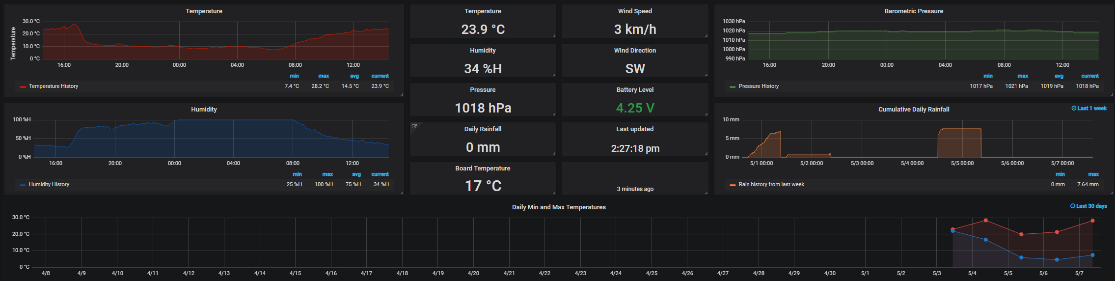

For reference, I’m working on “yet another vineyard project”: collecting weather and other data from tens of sensors on roughly a minute schedule. I’ve been pleased by the ease of setup and the general reliability of TTN. I can make some graphs (see below), but ultimately, I’d like to make spatial graphs and other things beyond simple line graphs. AWS QuickSight seems like a good platform for this, but that’s just one option is a sea of possibilities, I’m sure.
