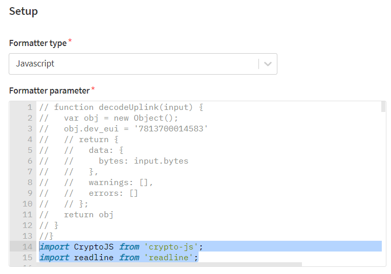

for getting correct information from payload, I need to do decryption with AES in JS. However, it seems that I could not direcktly import library from js. So, does someone know how to do it?
Thank you very much!

The TTN decoders are a convenience feature that can do simple decoding. A script can run for a very limited time and with limited facilities. The kind of thing you want should be done on your on server(s), not on shared infrastructure.
You can not import those libraries on TTN.
Something else:
LoRaWAN already encrypts the payload. If you use only the default LoRaWAN encryption TTN will decrypt the data for you. If you need to use additional AES encryption for data safety you should not be decrypting the data in TTN anyway because that will compromise the additional security.

The uplink, which I received from TTN, is correct but it is also encrypted by AES 128 from sencor. So, I need to decrypt this uplink and get information. In this situation, I could only decrypt this uplink in my own server, right?
Best wishes.
If there is additional encryption added to the standard LoRaWAN encryption you will need to decrypt on your own server. It would take too many resources on the shared TTN servers.
