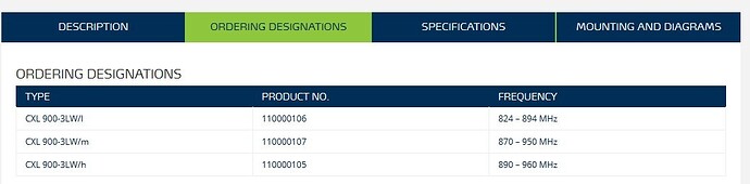

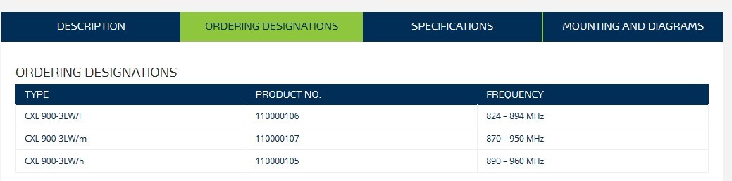

I can get the Procom CXL 900-3LW-NB/868MHz for €225 incl. VAT excl. shipping. Delivery time 3 to 5 weeks. Price could go lower if we order ten or more. Sounds like a reasonable price for a professional piece of hardware.
carefull :wink:
What do you mean?
ah ok, I searched for CXL 900-3LW and found 3 different types… but there are more :slight_smile:
