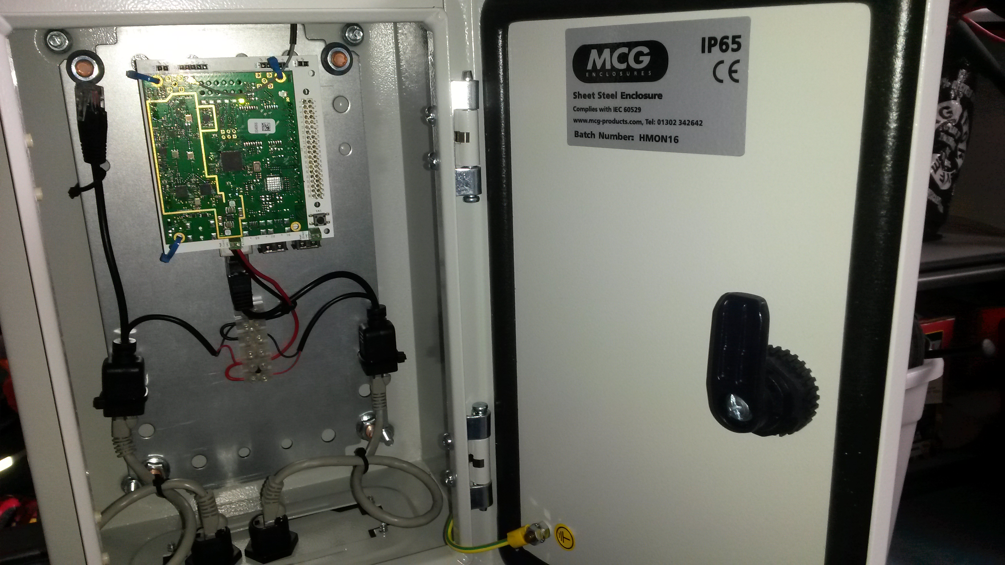

I build gateways into IP65 enclosures for industrial outdoor use. Usually IP65 rating. IP67 is very serious! It means you must support being submerged 1m under water for 30 minutes with no water entry. Is this really what you need? LoRa will not work under water! Please see attached picture. Steel enclosure is used to get good RF shielding. Cable glands, etc. also need to be IP6x rated. Grounding is also essential.20170912_140259
Did anyone verify that this box would enclose a standard Multitech Conduit AEP?
It does even in the smaller version of the box BUT you have to remove the internal backing plate.
