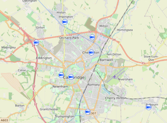

Nothing on the map does not necessarily mean there isn’t something there. Some gateway owners prefer not to share the location of their gateways. However if you have a node (== end device) correctly configured and no traffic is shown in the TTN console chances are high the map is right.

PS. I just notices I need to zoom to street level to find some of my gateways. I can find them because I know they are there, not because the map shows anything when looking at city level.
In the Cambridge area there are a few active gateways, so dependent if these are indoor or outdoor and your location. You might get connectivity via them, other wise like most of us add an gateway or two :smiley:. And see the others as infill for your gateways (but don’t depend on them)
That is a consequence of changes implemented byTTI teamin the wind down of V2 and before the sunset with V3 effectively a fresh start…unfortunately its a consequence of new implementation and lack of a central/global NOC, we were promised some of these old features (user names et al) would be re-implemented once V3 ‘settled’ but we are still waiting :frowning: Not knowing who is kinda a challenge for community cohesion and communications…I often see new GW’s in Communities where I am initiator but them cant contact user directly to ‘join’ :man_shrugging:
Its still alive - and I know of many nodes happily pinging away and passing messages through the (visible and invisible) GW’s around Cambs… :wink: As to the GW’s the community page is colour coded…blue = alive/active, red = alive but not seen as active for a period (typically 24hrs these days but can be a few hours to a few days!) if a previous GW drops off the map it has not been seen by the backend as handling messages or passing status updates for ~1 month! Believe the main map I linked to shows GW’s seen in the last approx 2 weeks… IIRC.
