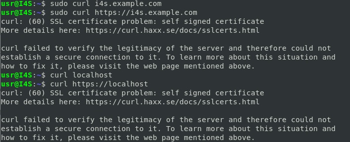

Now some curl from the host curl

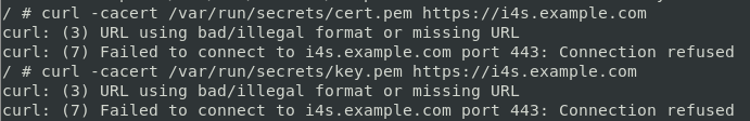

but, if I execute the same from the ash console inside the docker, I get a
(7) Failed to connect to i4s.example.com port 443: connection refused
Now another curl:
From ash, I typed:
cat /var/run/secrets/key.pem
cat /var/run/secrets/cert.pem
and both were successfull.

I tried accessing with the CLI but I get an error which basicaly told me that the certificates were for “i4s.example.com”, while I was trying to access localhost.
So, I generated the certificates for localhost and checked them with
“openssl verify -CAfile ca.pem cert.pem”
also, from inside the container:
cat /var/run/secrets/ca.pem
In both case I got a positive response, but once I tried to access the CLI I got an error due to unknow authority. Still working to fix it… not sure if maybe I have to re-initialize the stack from the beginning.
I think your issue is similar to the one we solved in github - certificates for the host and the docker container are different. Try following along here - https://github.com/TheThingsNetwork/lorawan-stack/issues/2353#issuecomment-617020487
If you’re accessing the docker container from outside the container, it won’t be at localhost.
