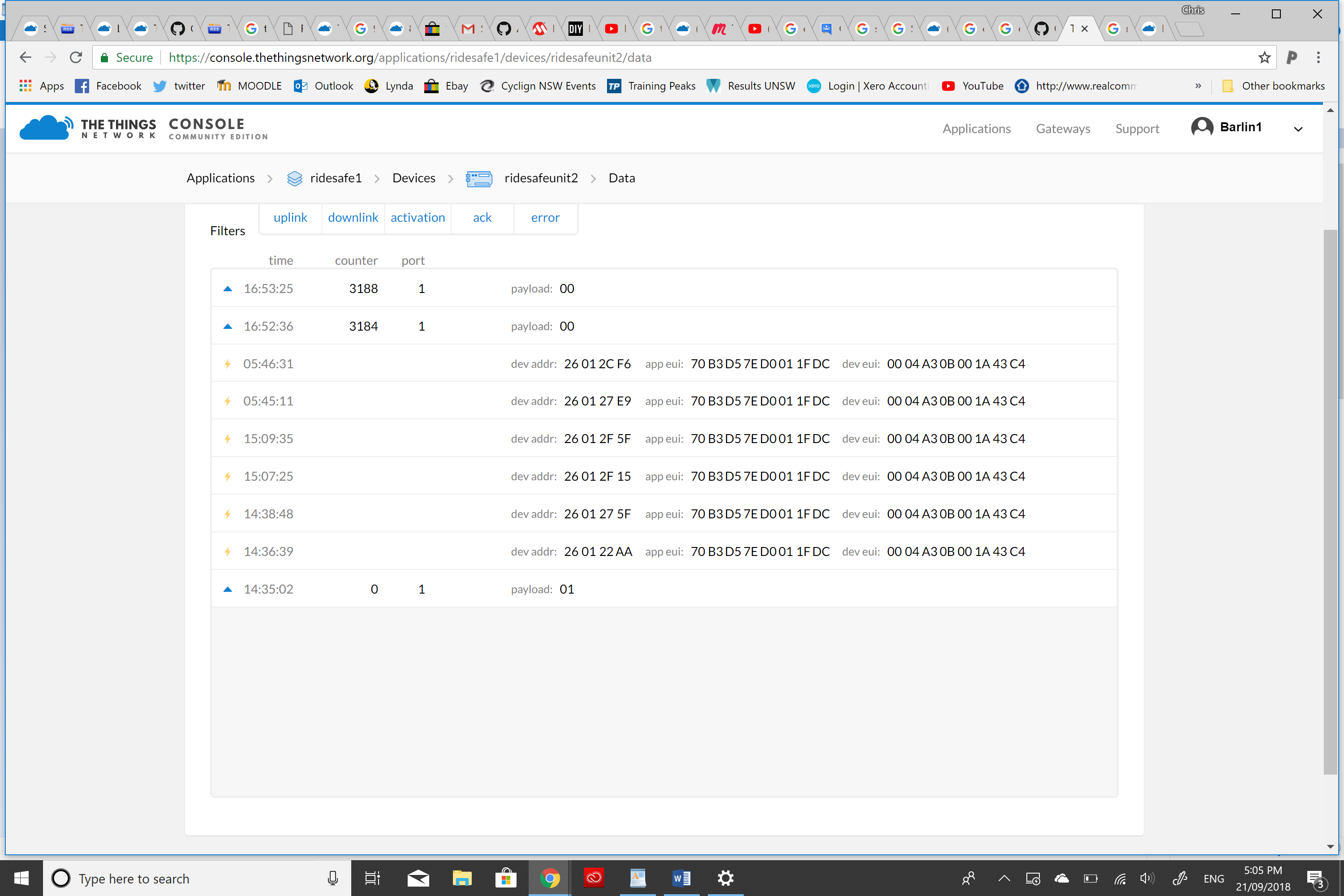

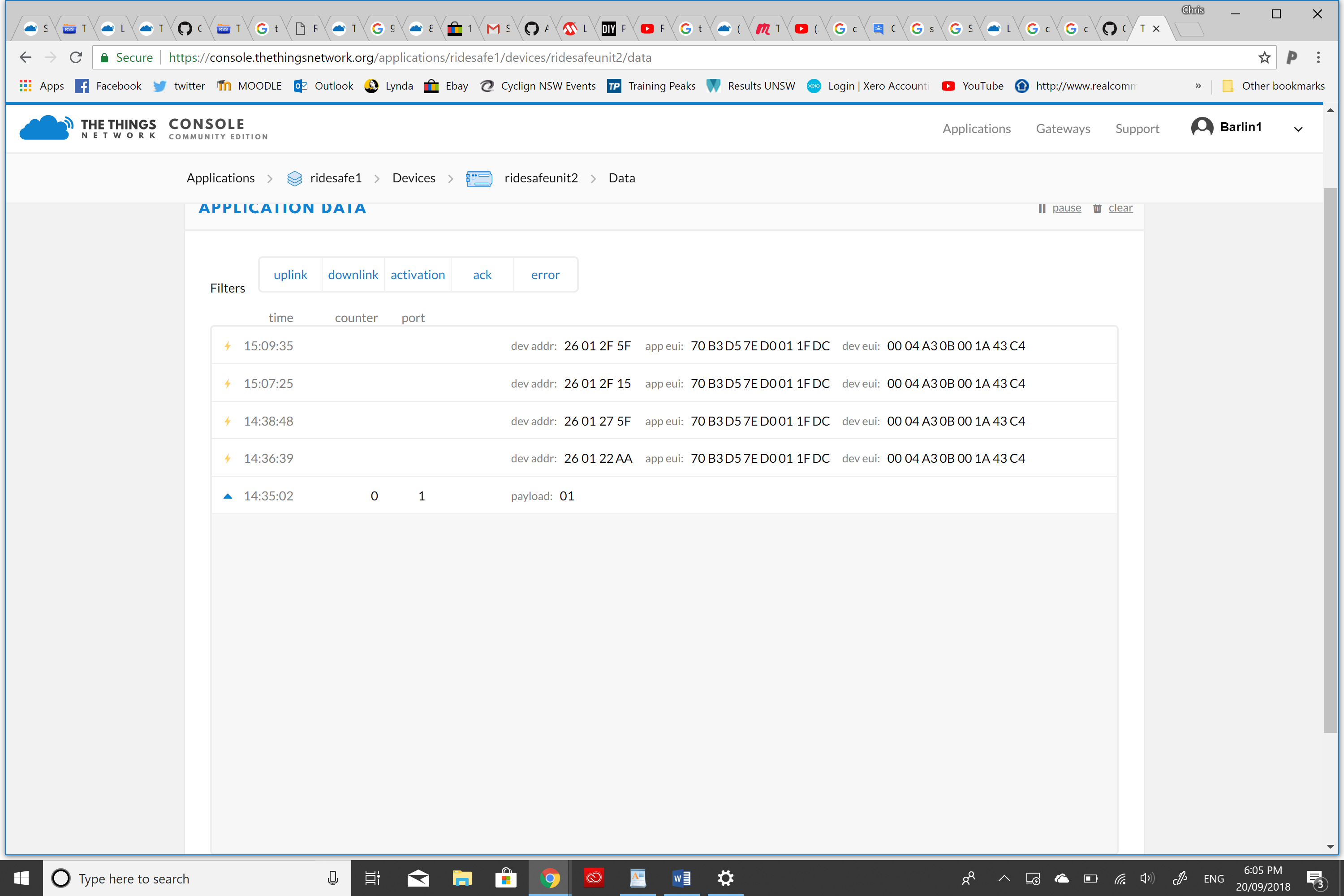

Screenshot of the node connecting VVV
Screenshot%20(18)

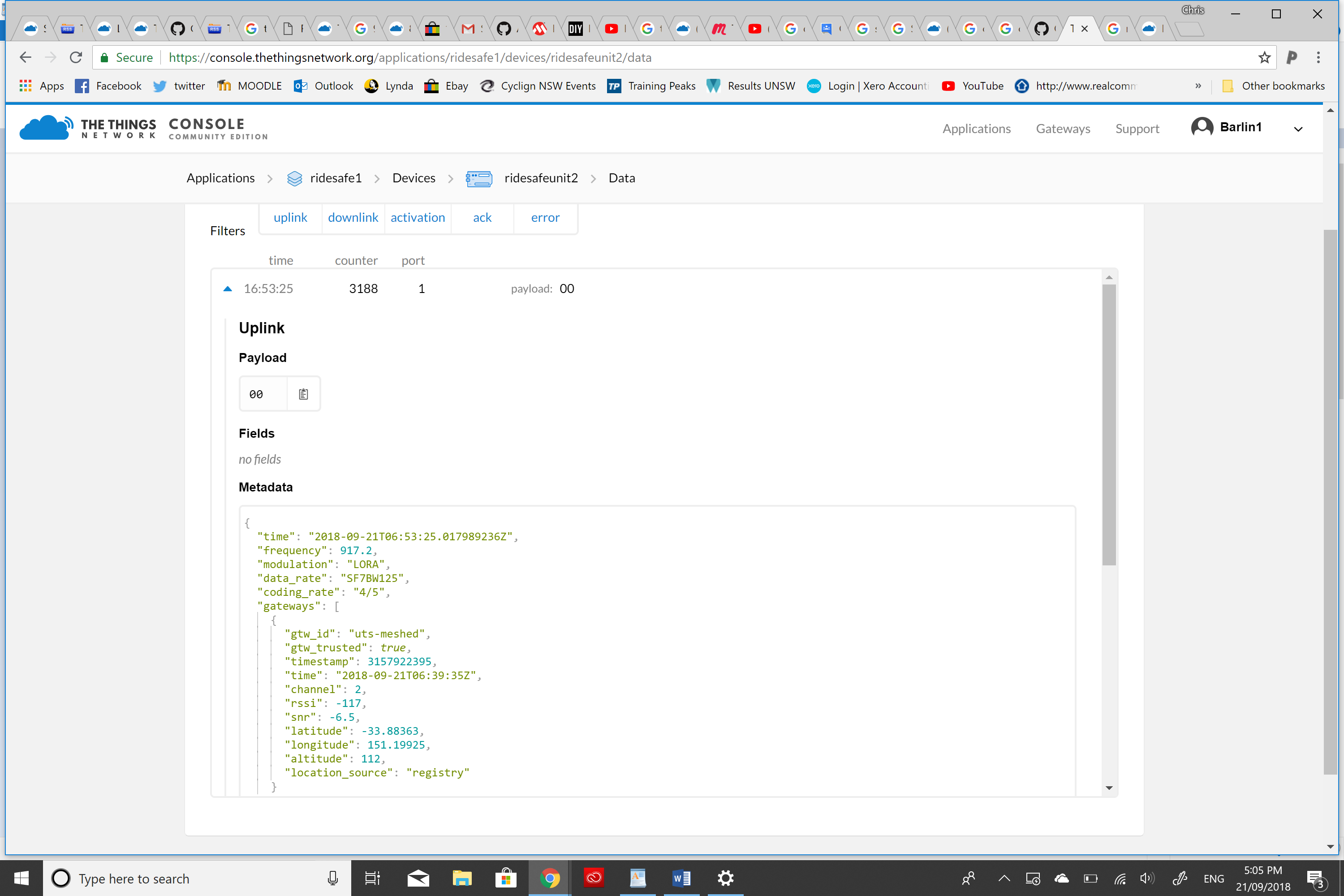

Screenshot of the information when the node connects to the UTS-Meshed gateway VVV
Screenshot%20(17)
