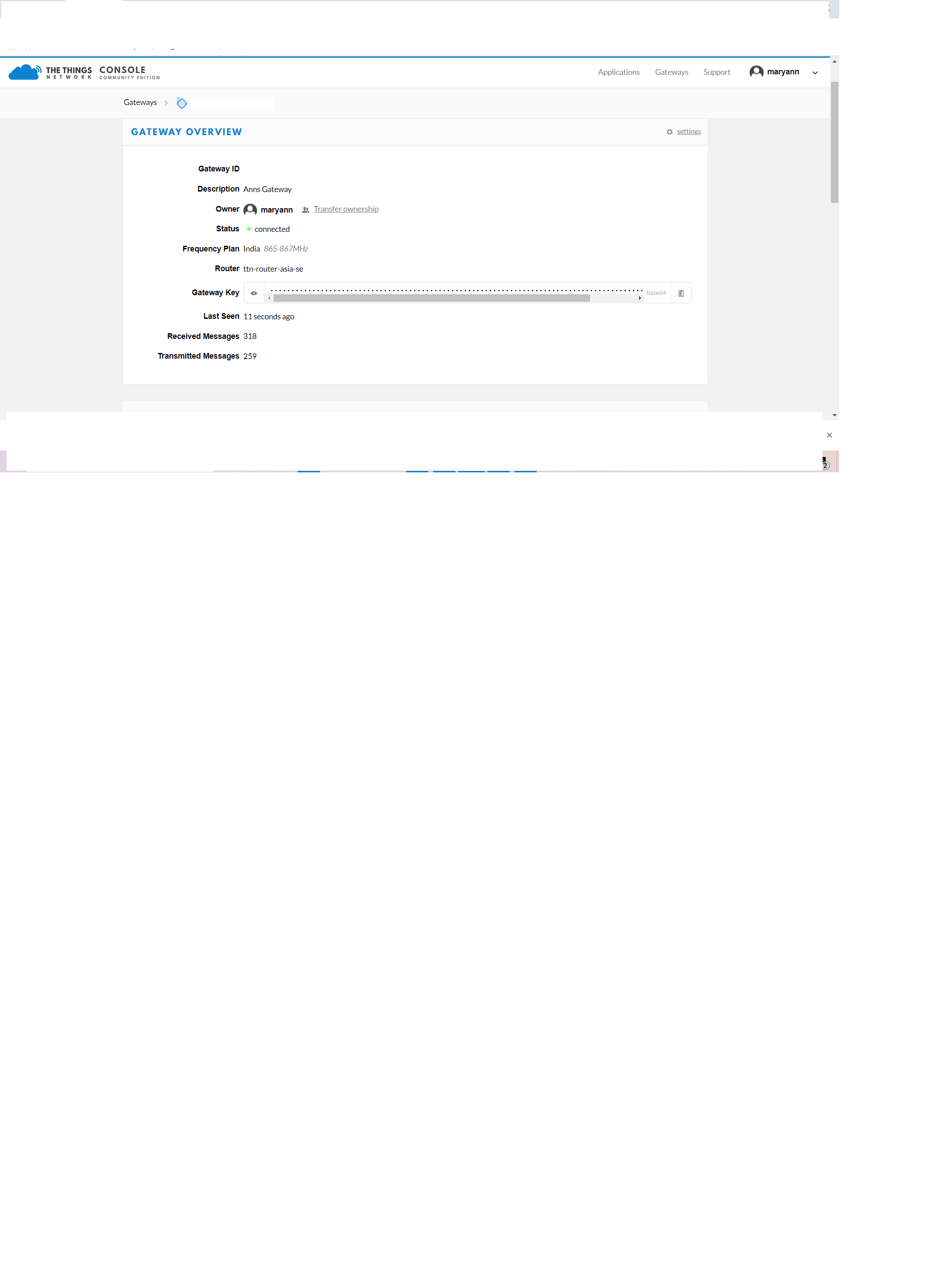

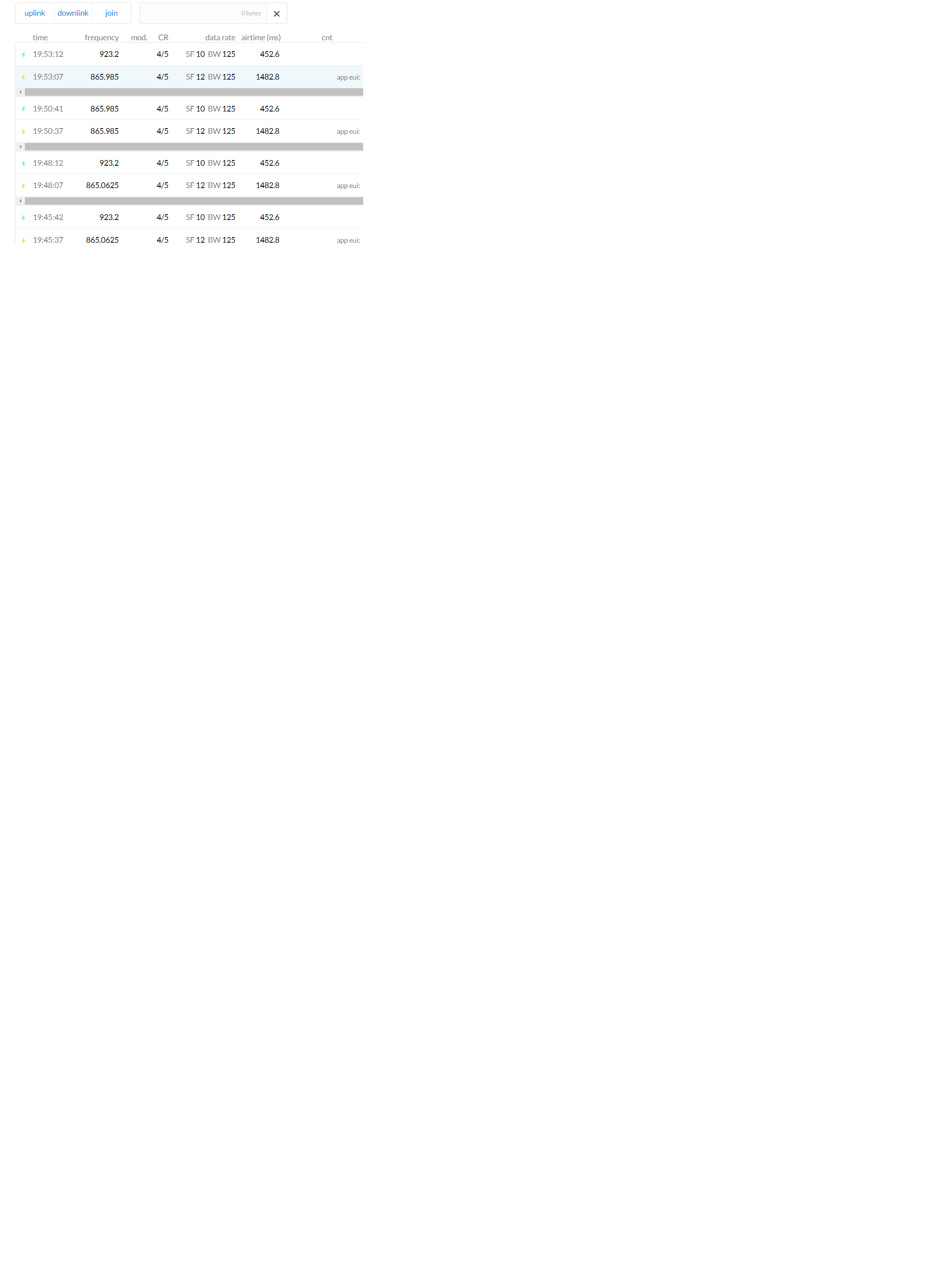

Please have a look at the TTN screenshot of the gateway Overview and Traffic -

Can you ensure the images you upload don’t have lots of white space on them.
