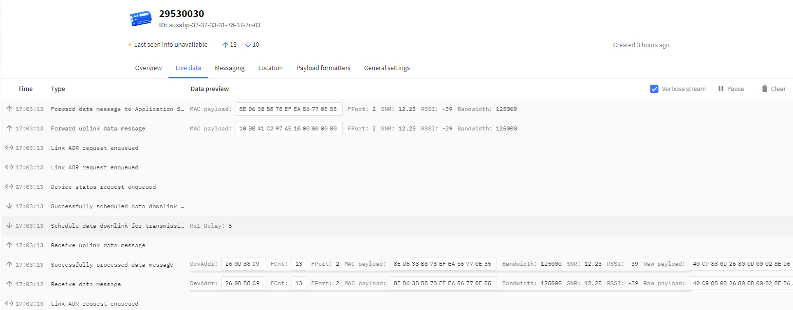

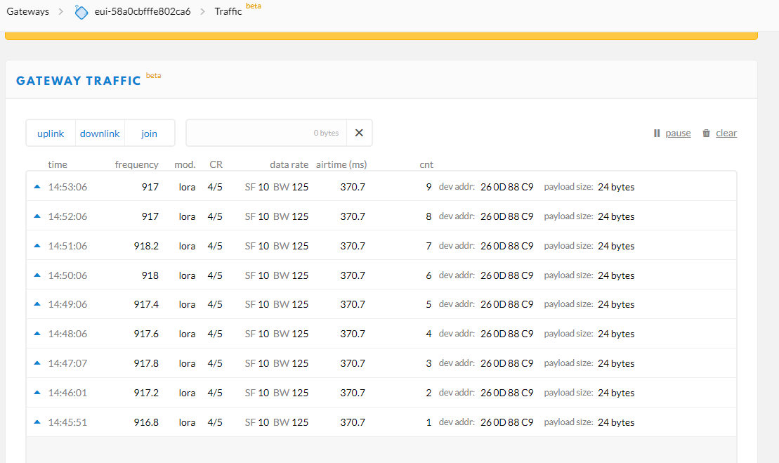

The screenshots below refer. Have registered a new V3 node with ABP and the uplinks are received 100%, It would appear that the downlinks are not forwarded. The downlink scheduled at 14:52:07 on the Live Data preview screen for the node does not appear on the V2 console gateway traffic log. Are all downlinks not getting forwarded?

This has highlighted one of those bits of info that I’d not recalled - the v2 console doesn’t show Join Accepts or Downlinks.

I’m almost 100% certain downlinks are not getting forwarded as the ADR is not kicking in. At a RSSI of -48 and a SNR of 11.75 the data rate should speed up to SF8BW125 quite quickly. The live data for the ABP node (verbose mode) is enqueuing ADR requests to switch to SF7BW125 and these are not getting actioned by the node.
