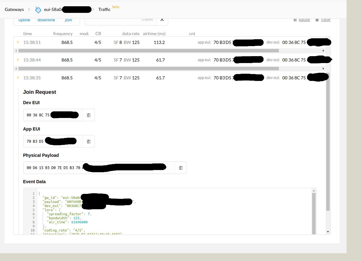

When I’m trying to connect to TTN with the custom board, I can see in gateway traffic section, the join request event, but no join accept event is generated.

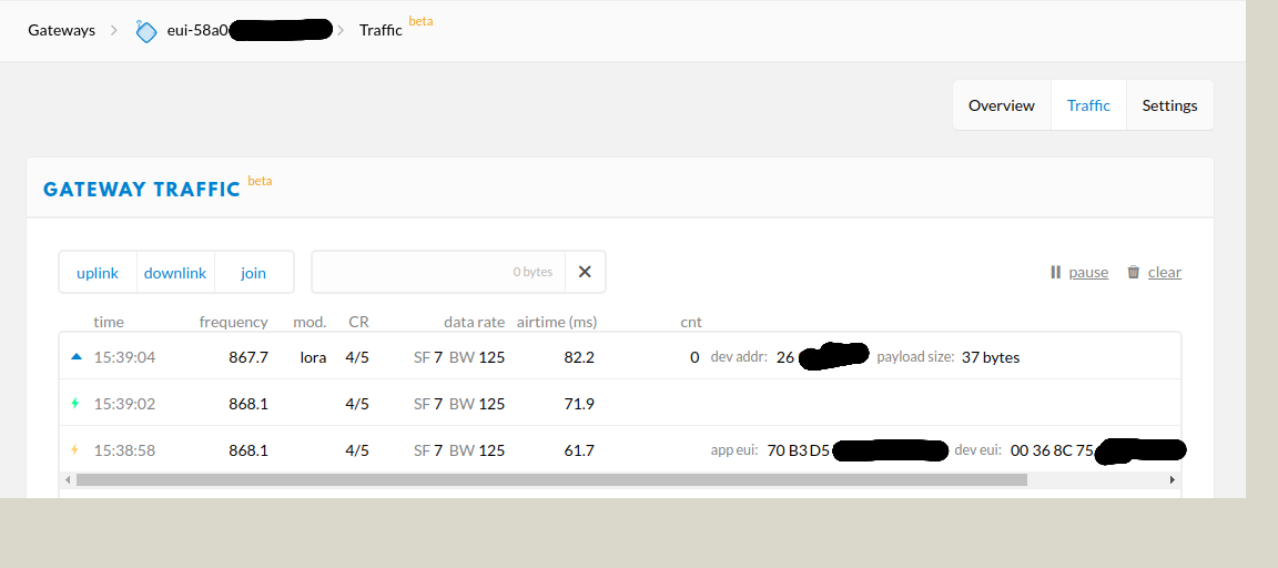

Using the same code and same keys but with SX1272MB2xAS shield, everything works just fine.
It’s hard to determine the root cause for this issue because I don’t have additional information in TTN console to understand why the join request was rejected. I also don’t have a lot of experience in this domain, so what I need is a little guidance with regards to possible causes for this issue ( it might be a hardware issue, it might be a mbed issue, or maybe I did something wrong in TTN configuration).
