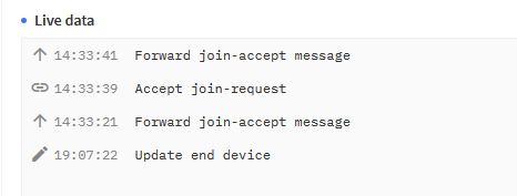

Hi, I need some help. I have two V1.0 T-Beam boards, one is working as I expected and one is not. The failing one will, upon power up, send a Join request that I see on my gateway as an “Accept join-request” and then a “Forward join-request message”. After that the device keeps posting messages, I am using a GPS tracker sketch (GitHub - kizniche/ttgo-tbeam-ttn-tracker: TTGO T-Beam Tracker for TTN Mapper and TTN Tracker using US (915 MHz) and EU (868 MHz) frequencies) that posts the GPS location every 20 secs. I see these messages also on the gateway but they never go to the end-device application I have defined. I do know it save the session keys so I modified the code so it would force a Join every time I reboot it just see if something it has saved from a previous session is causing it to not work. Any ideas as to where I can start looking? I have tried deleting the end-device and making a new one but still the same issue.

I used to use ABP early on but as it was recommended to use OTAA for better security so I focused just on that protocol with all my LORAWAN experiment and I have not tried these boards using ABP. I would prefer to get OTAA working. I do not see data arriving in the console. That is the problem. It does not reach the application to use a payload formatter. I see the packets hitting my gateway in live data and can recognize the device address. I also use an SDR to see the T-Beam transmitting so I know it is sending out data.
The working one, called T-Beam1 with a sketch of the same name, joins and then every 20secs sends its GPS data and in the application I use a java formatter and see the GPS coordinates. T-Beam2 uses the same sketch except that credentials are changed to match up with the t-beam2 end device in TTN. What I see for that board is an Accept join-request and then a Forward join-request message. Nothing else in the application.

When the non-working one starts up, from the serial console, it says EV_JOINED and displays the new device-id and session keys. Then it proceeds to send the location data every 20 secs as shown above.
My thought as to where the issue is lies with the data the sketch saves so it does not do a join every time the device reboots. Would it have something to do with the FCnt value? I read that it is suppose to reset to zero when a device joins. I don’t see that happening with my devices. I modified the sketch to force a join every time it boots and FCnt value never resets. Or is that value kept track of on the TTN server?
