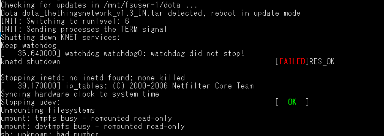

Kerlink IOT station 868 Gateway reboots continuously after TTN packet forwarder update via USB
  • I would like to configure the TTN Package Forwarder for EU868 region for my Kerlink IOT station 868,
  • However, the link has been expired. (https://github.com/TheThingsNetwork/kerlink-wirnet-firmware/tree/master/dota)
  • I renamed the dota_thethingsnetwork_v1.3_IN.tar.gz to dota_thethingsnetwork_v1.3_EU.tar.gz and was able to update the
    fuser-1 with a things network folder. But the gateway keeps on rebooting.
    knet shutdown was FAIL during this time. [ Previously was able to make another gateway working by this way]
Please have a detailed look of the get_version command below
[root@Wirgrid_080e0097 /]# get_version

Hello,
Thanks. Issue is solved after reflashing the wirnet firmware again.
I was able to solve the continous reboot issue and further update the ttn packet forwarder to make the gateway working for EU868
