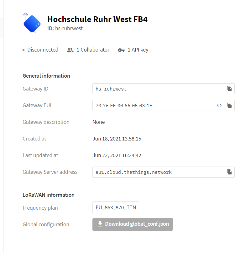

However, the gateway is still not connected to the things stack and I don’t know what the problem could be.
What makes you think that - because that will give us a clue of what you might need to do.
I thought it was connected because i changed the server addresse In lorafwd.toml under gwmp the node to “eu1.cloud.thethings.network” and the port for uplink and downlink to 1700. As described in the documentation. What else do I have to change ?
So you’ve not seen any hard evidence that you are connected - nothing in the logs of the gateway or on the v3 console?
No, i have not. In the Overview of the things stack is the gateway still disconnected.

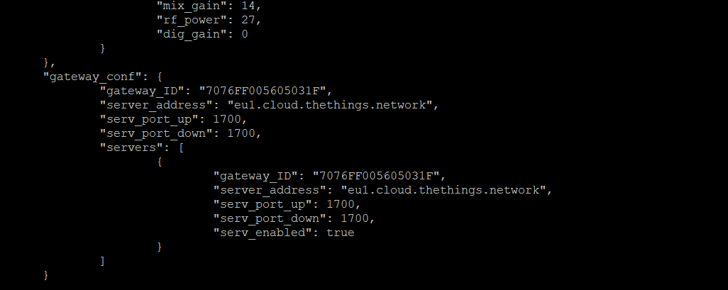

Sorry I am a little confused. I have now downloaded the globa_conf.json as here:
https://www.thethingsindustries.com/docs/gateways/semtech-udp-packet-forwarder/
Now I have to put in the file /etc/default/lorad at CONFIFURATION_FILE the globa_conf.json I just downloaded right ?

Please do not post pictures of things that can be copied & pasted.

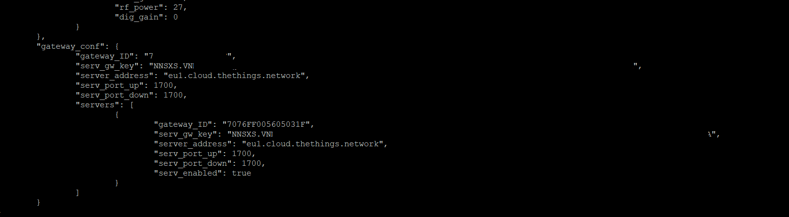

Can you copy & paste the global_conf.json section with removal of some of the letters in the API Keys, just so another set of eye balls can have a look see.
tempsnip
        "gateway_conf": {
                "gateway_ID": "7076FF005605031F",
                "serv_gw_key": "NNSXS.VNN...PXJQA",
                "server_address": "eu1.cloud.thethings.network",
                "serv_port_up": 1700,
                "serv_port_down": 1700,
                "servers": [
                                "serv_gw_key": "NNSXS.VNNPXA...PXJQA",
                                "serv_enabled": true
