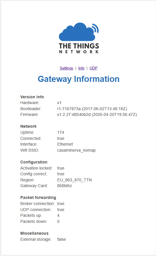

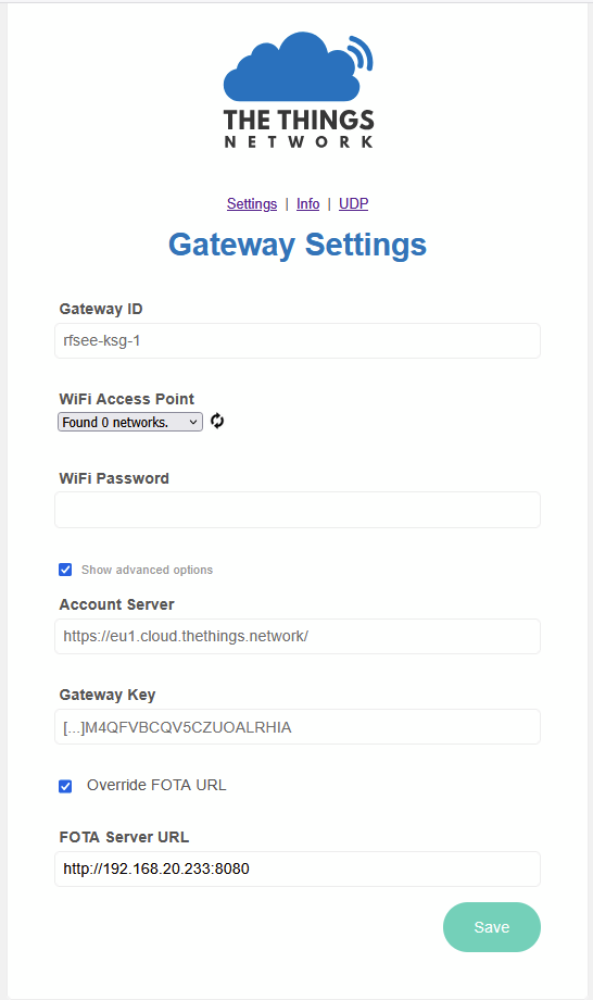

Fix 1: WiFi AP Always On The first issue I tackled was the WiFi access point being permanently active, even when a wired Ethernet connection is present. The 2.4 GHz band in my shack is already crowded, so silencing any unnecessary interferer is very welcome. Claude’s analysis revealed code that was never called and incomplete logic governing the WiFi client, AP, and Ethernet connection. A solution was proposed, I implemented it, compilation succeeded, and, since my PICkit4 turned out to be dead after years of sitting unused, I tested via SD card. It worked!
Fix 2: Expired Certificates Feeling confident, I turned my attention to certificates embedded in the code. Claude flagged one that had already expired and another due to expire shortly. Since I intend to keep using this gateway, that had to be resolved. A plan was drawn up, verified by me, and executed. And it worked!
If you want to test this on your own KSG, you can download the SD card firmware here: gateway/releases/1.1.3 at upd-only · pe1mew/gateway · GitHub
