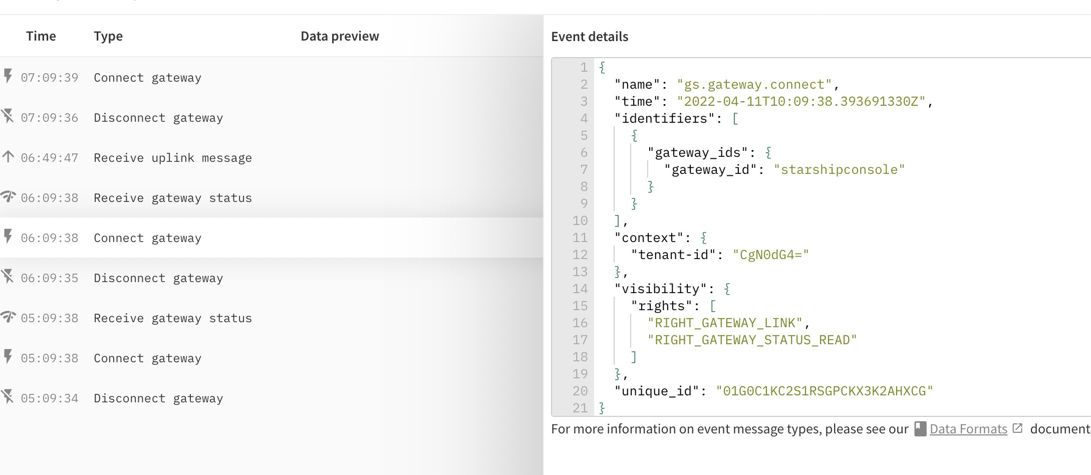

I seem to have the gateway working well except it drops from TTN after every hour
My gateway Wifi signal seems strong. Perhaps I’m missing some setting or there is an authentication timeout? Any insight you could share would be appreciated!

Do I see this correctly, does it sent only 1 status message and becomes quiet ? It could be your firewall terminating the connectivity due to inactivity - what gateway model are you using ?

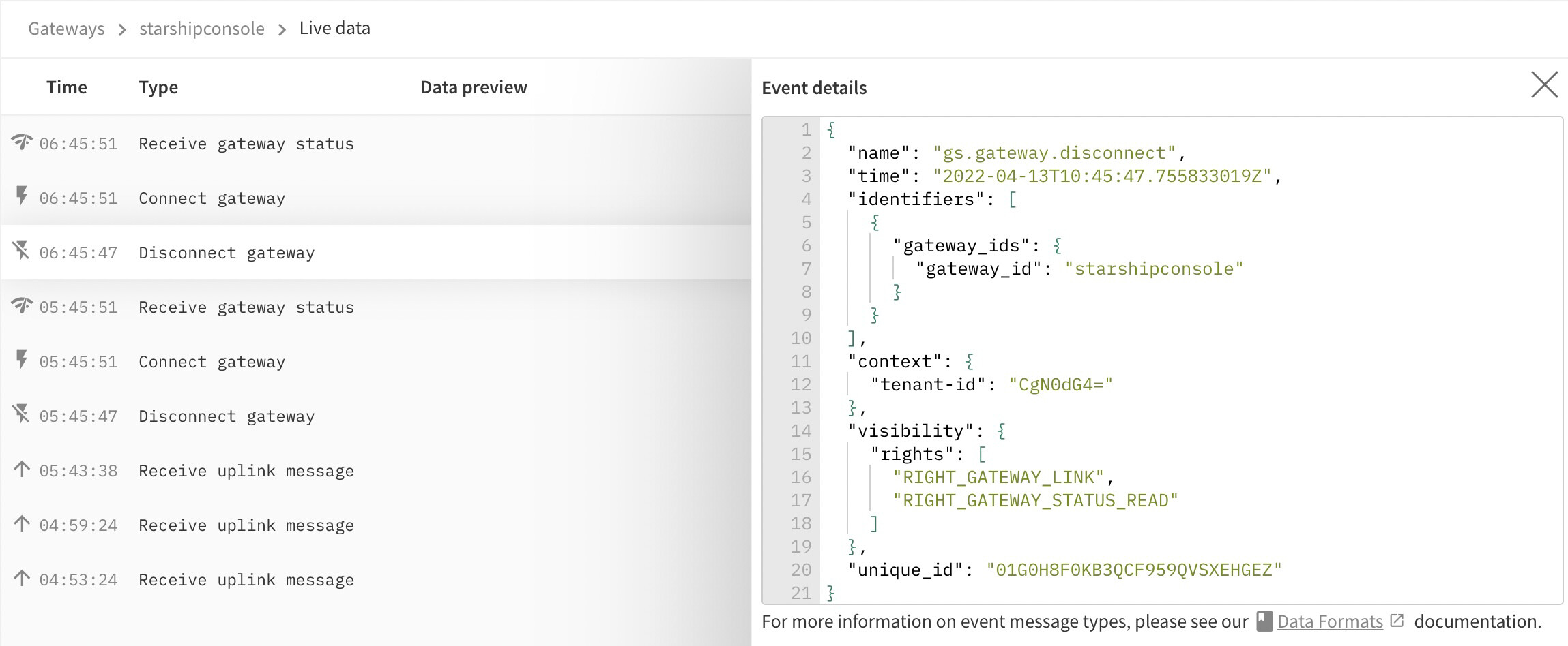

No real issues with PING/ICMP that I can tell of. Especially with it dropping on the hour.
I checked the firewall logs. I don’t see anything specific to that host (DHCP expiration, etc). None of my other devices drop at 1 hour increments. Certainly strange.
I don’t think this is a firewall timeout issue.
I had a couple of packets flow through – and then 8-9 mins later it dropped on schedule

Agree. I’ll look into a capture but saw where there was active traffic just a few minutes before a recent disconnect. If thats the case, there should be some variability in the drop schedule specific to idle time, no?

Your first post only has screenshots from the TTN console, no gateway logs - gateway logs are from the gateway’s perspective, not the server’s.

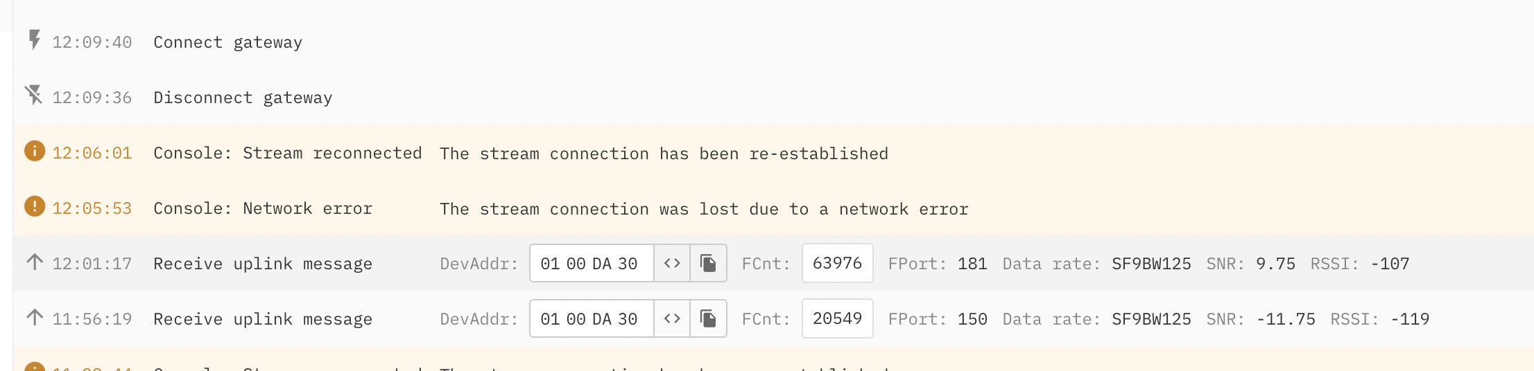

Hi, I have a similar observation with a gateway that uses MQTT protobuf protocol. Until now I have not been able to identify the source of the issue. I tend to think that TTNV3 is contributing to the issue by some “too tight” timeout timer.
