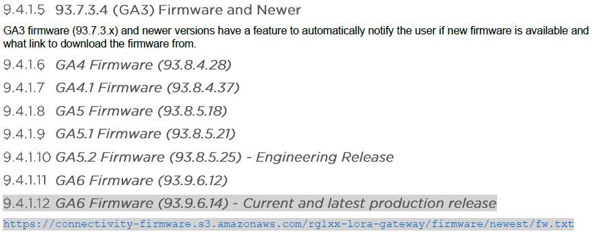

  2. Is there any way of verifying else where that the latest firmware is actually 93.9.6.14(GA6.1)?
I’m wary of any technical updates that are supplied in this sort of format as it’s reliant on someone keeping the PDF up-to-date rather than it being automagically listed in some download directory.
My current workaround is to remove the two channels from the firmware, it joins, the CFList turns them back on and all appears well with the world. But I’d rather have all eight to hand as a mass deployment is due soon.
My Laird RG1xx is US902-928.
The latest firmware is ā€œLaird Linux gatwick-laird-93.9.6.14ā€ per my Laird RG1xx dashboard. That is consistent with the current user guide at https://www.lairdconnect.com/documentation/user-guidedatasheet-rg1xx-rg191lte

Although I still don’t like finding a PDF of release notes to get a link to the latest firmware.
