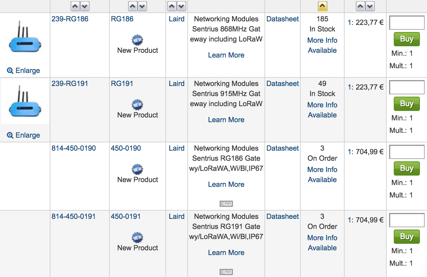

Here in N.Z the RG191 costs NZ$430 while the outdoor version will be NZ$1546 which is outrageous.

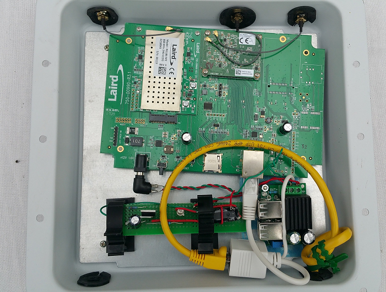

I just moved an RG191 into a metal enclosure, added an N-type pigtail, 1 metre antenna cable and a L-Com HG908U-PRO antenna and the upgrade cost me NZ$250.
Ha I did the same thing when I saw the price difference also, it was a nice surprise to see the ufl connectors when I took it apart
Nice work, looking flash!
I have the WiFi disabled, but just in case it’s ever enabled, I decided to leave a simple 1/4 wave antenna attached. I just sacrificed the U.FL to RP-SMA pigtails to make them and stripped the coax shield off for ~31mm

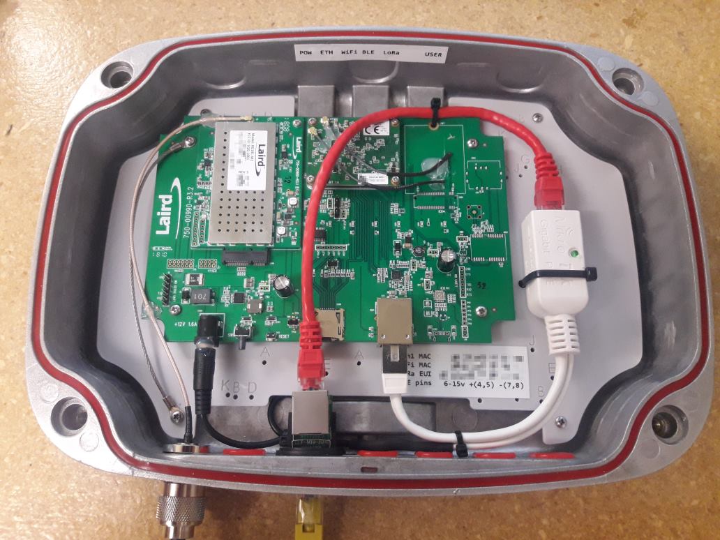

Did something similar - and set up a low voltage PoE feed - but careful angling of the board in housing allowed me to keep the Wi-Fi components as supplied as immediate option vs just wireline Enet

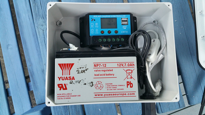

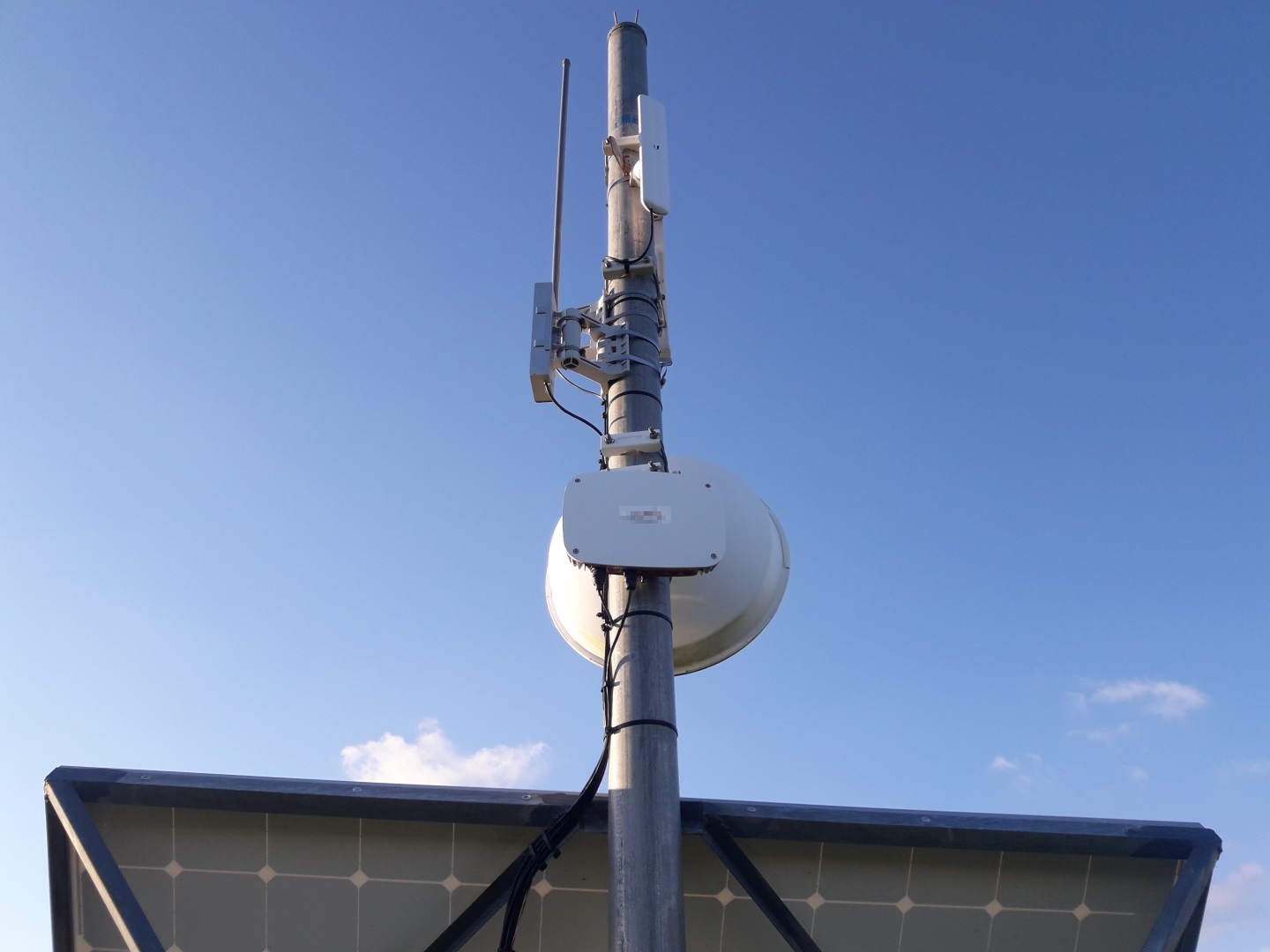

GW is mounted on a ~10m mast with head end/GW upgrade from internal Laird supplied unit to external IP6x rated system costing <£100 in materials…power feed is from a mast base mounted Battery/Solar controller/Enet tap (for GW management/config without having to bring GW down or for backhaul connection if not on Wi-Fi) with external solar panel. Total cost for power source update materials approx £90-£95.
Nice one! The weather held off today for me to deploy my first RG191 gateway out into the field. Antenna is a L-com 8dBi omni.
I haven’t fully tested it out yet, but I ran TTN Mapper on the way home and got all the way home (14Km line of sight) and was still getting packets through.
