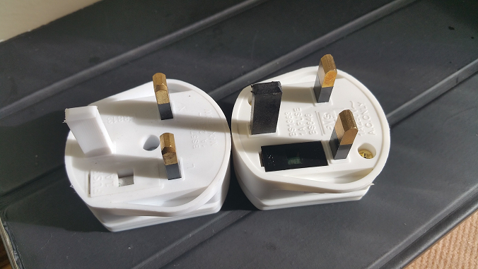

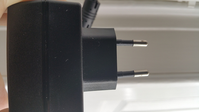

Interesting to see you have issues with supplied main adapterā¦that is also a big problem here in the UK - so a heads up for UK users to a deployment problem I have experienced - where EU rules allow suppliers to ship in mains adapters where the pins are not specifically designed for UK traditional 3 Pin socket use.
This is typically as supplied:
Which forces the use of one of these to adapt to UK 3 Pin outlet:

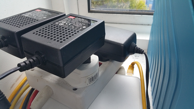

Before deploying to the field I usually soak test configured units for at least a few days - and often 1wk to as much as 1month before pushing out the door.
In the office/lab several may be on test at a time:

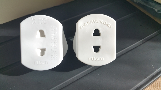

Late in the summer I had a problem with a deployment in N.East UK where install kept dropping off lineā¦long story short TL::DRā¦problem turned out to be plug was vertical mount as usual for mains sockets vs office lab testing horizontal:
It turns out that the sideward/vertical load of weight of plug/adapter combined with differences in contact metal shape and area of the various āshaver styleā adapters meant that, esp if combined with slightly bent/deformed main adapter pins as seen in photo, a small amount of ācreepā was enough to break mains connection causing unit to go off lineā¦a re-seating and holding with tape solved initial problem but it cost 2 day trip to other end of country with attendant costs and opportunity impact + damage to client confidence to get resolved!
Now have to be very careful what type of adapter used for installsā¦with another āsuspect siteā due for a visit shortly!

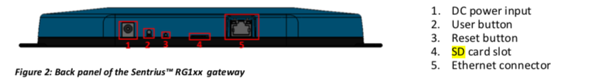

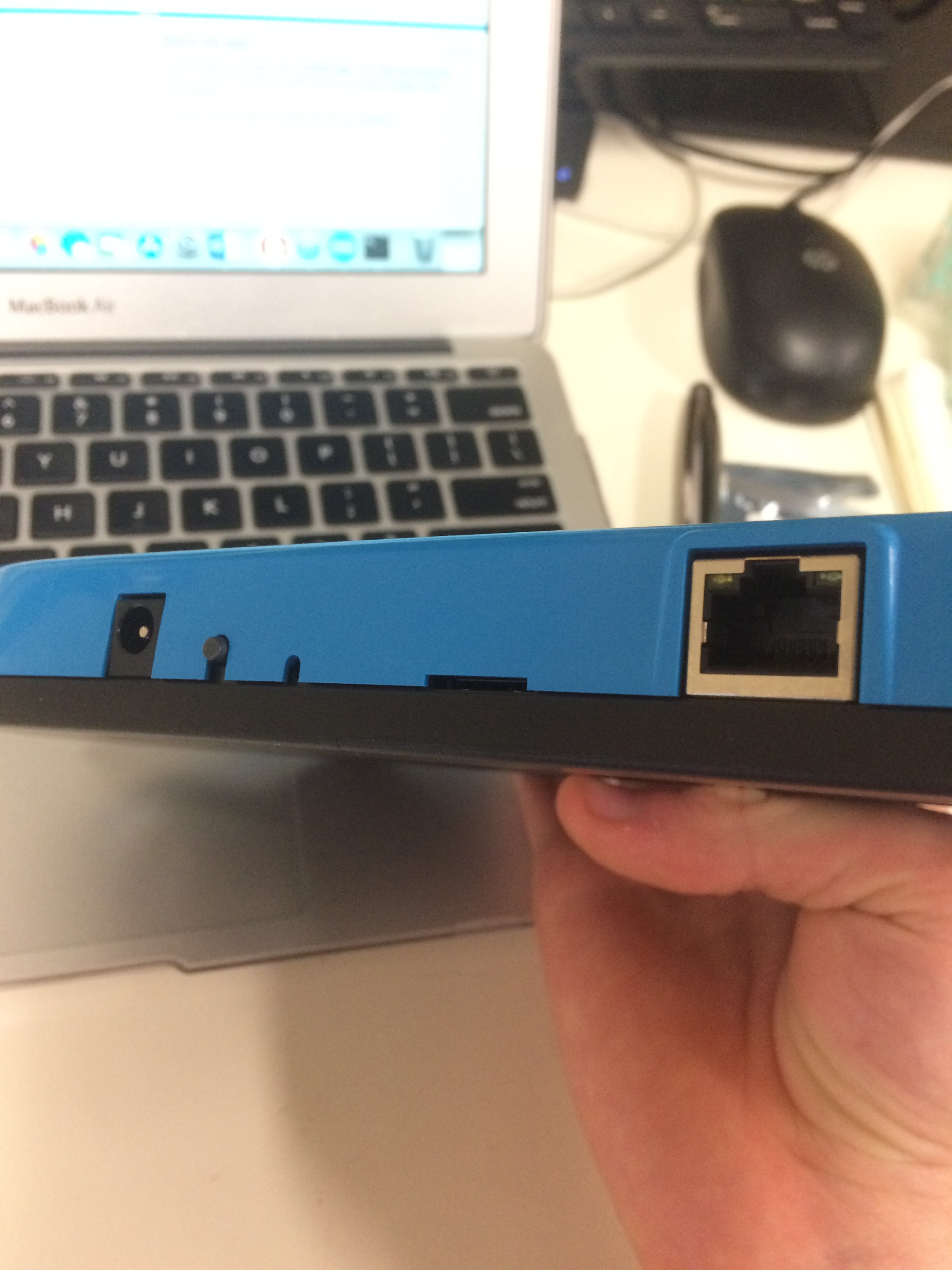

Just a couple of things. Do you know what the SD card slot is used for? I canāt seem to find any documentation on it other than a mention of where it is located in the user guide and no forum seems to describe its use.
In addition, other than the power adapter problem, why have you stopped using the gateway and what have you switched to instead? Do these newly chosen gateways provide greater functionality/ features as well? I know thatās quite a few questions, but I am going to be deploying a few gateways and really want to provide the best value for money solution for my clients and seeings as youāve done quite a few, I might as well ask you.
Keep in touch.
From discussions I have had the SD card slot is not (yet) an end user service item. may get used for future features/capabilities or in connection with cellular upgrades, hence you wont find many references to it other than its location. Iām hopeful it may get s/w update to allow local storage option or for easing s/w updates etc. but donāt hold breathā¦

The SD card slot is in use and has been ever since theyāve released this unit. It gets mounted at /media/usb0.
Iāve been planning on releasing a video on how to get root on this device quite easily by using the sdcard. My RG1XX is thoroughly hacked for GPS, VPN, remote logging, ssh, lora-gateway-bridge and various other things. This unit isnāt closed or proprietary really.
