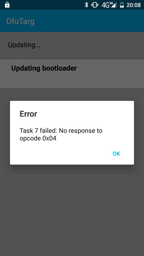

I have used these units in the past and had no problems updating the firmware via mobile app to use with Cayenne/LPP rather than Laird proprietary payload (f/w 4.5 for obvious duty cycle benefits) . However, had a few units recently and during f/w update process stopped with error -
Updating bootloader - xxx of 1137 Error Task 8 failed: No response to opcode 0x04 OK
It makes the unit unusable - some units seem to respond by pressing down the BLE button for 30 sec and reset but others do not.
Anybody seen this or have an idea how to fix? Laird support contacted but no response.

Just a quick update - this issue was experienced when using an ios device running software version 12.3.2 which seems to have been the issue. When I installed the Sentrius Mobile app on an iPhone with ios version 12.3.1 (I assume anything lower will work as well) the units successfully updated their firmware without hanging up. No support from Laird but suspect incompatibility somewhere.

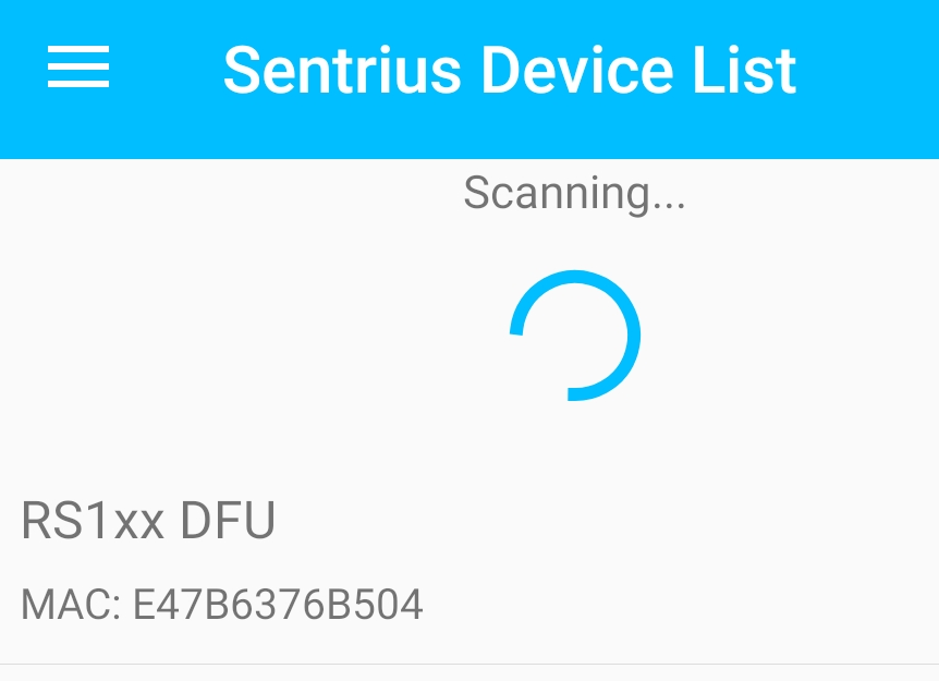

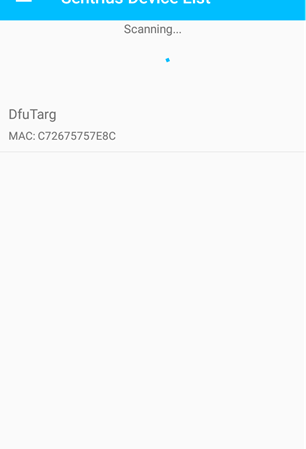

My node at starting (just after putting the battery inside)
then on the phone
then
Always block here.
pressing BLE button have no effect.
Who could help me?
The error arrived because, I have try to downgrade the firmware from 4.5 to a another! The apk give you the option, but never do this!!!

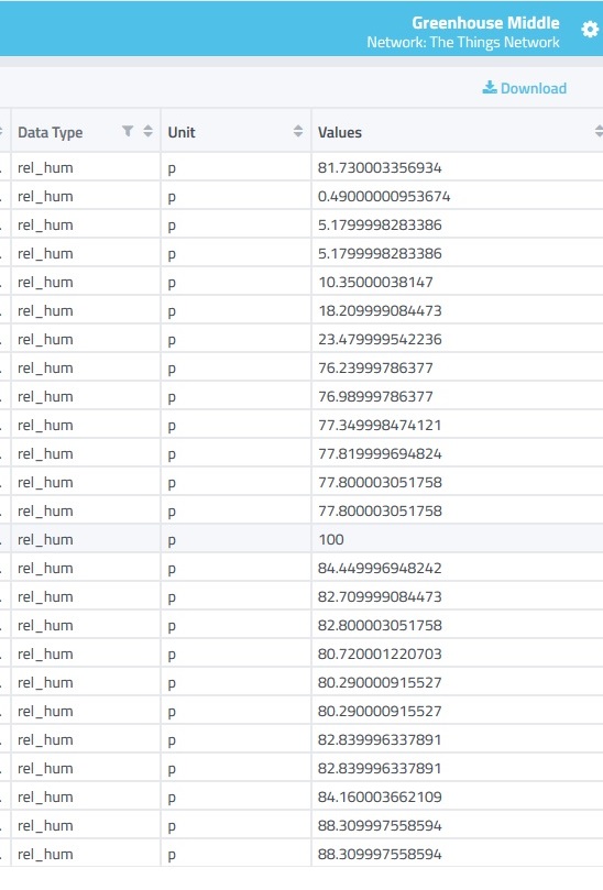

I am experiencing incorrect humidity readings on one sensor during my tests and suspect condensation on the sensor. Working on the heater control message to see if I can resolve the issue.
Faulty%20Humidity%20sensor%20readings

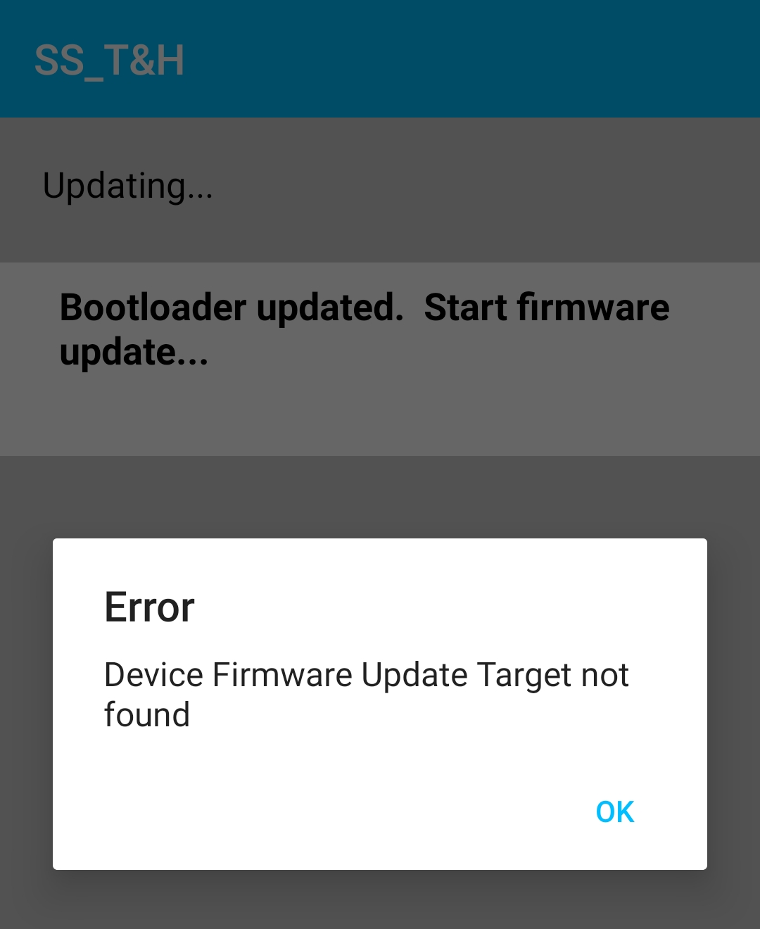

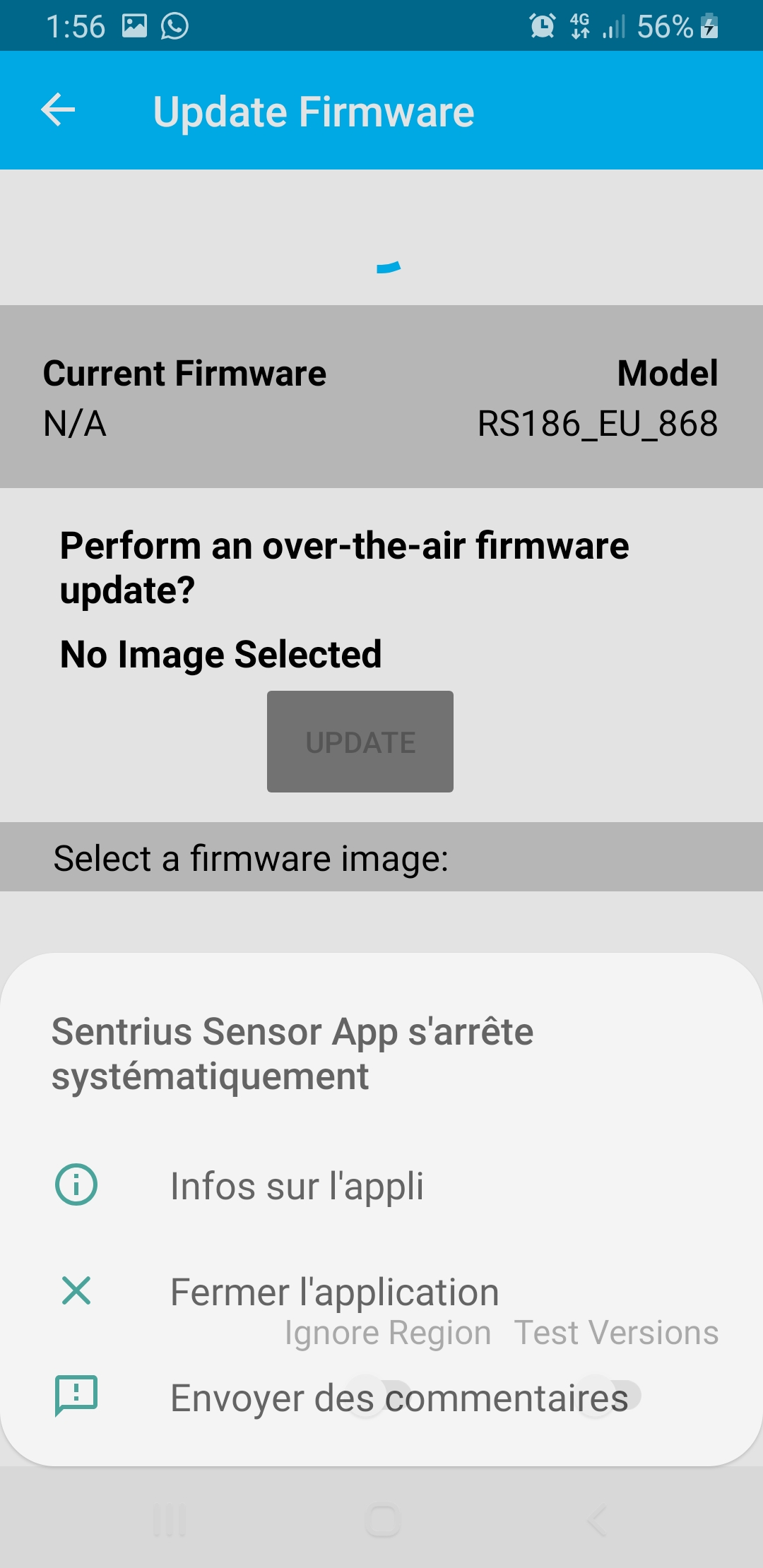

So put the batteries inside the node, push on the bluethooth button and connect it with my phone.
And try to update.
BUT ERROR !
I send a email to support…
So it is an application error ? :grimacing:
My NEW node is in DFU mode
I couldn’t do anything…
and then
I asked a colleague to lend me his iphone.
I installed the app.
and it worked. I made the update and I change the mode in Cayenne
So Android App don’t work…

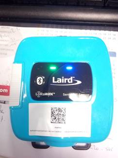

Looks like I have same/similar issue - after configuring/updating many of these units no problem over last year or two I finally have a brick!
Two solid leds same a @kelu28 near top of thread. In my case am using Android not IoS and have used same phone for many such updates, though I did see Google Play updated Sentrius App version recently (App version 5.0.0)… :thinking:
Unit took some time to connect over BT when 1st powered up - at least a couple of attempts and long waits each time. Eventually had it up in TTN App console and set up integration to Cayanne. Data was correctly decoded in TTN but incorrect in Cayenne dashboard (Temp @104/105 and hum -45ish!) usually solve this by swapping to use basic Cayenne LPP as ‘device’ vs the ‘official’ RS186 device set up on drop down menues. But as phone app was complaining device on old firmware (5.2.x.x?) and to update I figured change between switching set-up in Cayenne.
Device found the 5.4.x.x. firmware no problem and started in DFU mode and began updating Bootloader. Looked to get to around 50-60% complete (did I see 56/57%?) then saw a failed to run Task message similar to above - not sure if Task 8 or 9, on retry saw the Task 7 message same as above, now on start up it is stuck in DFU Mode, App not responding as awaiting the Device to respond (working fine with another unit I set u just afterwards (straight to Cayenne LPP mode on dashboard). And LED frozen on solid Green & Blue. I note they blick in sync briefly approx every 30 secs - so a watchdog or something still running?
Anyone know how to recover or do I have to send back to US Disty? (These are EU 868Mhz units) @deadpan Really dont want to go trawling for old apk’s etc. if that is only solution unless Laird send me something directly.
