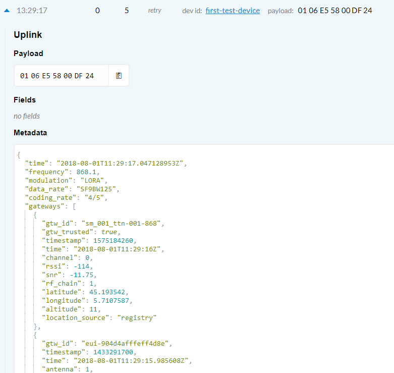

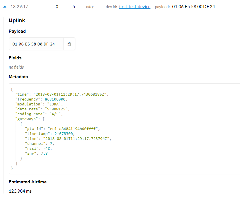

I having an issue with a packet send by my node to TTN. It appear twice into the application console:
the first duplication regroup every gateway that receive the message except one (mine, a LG01 for testing purpose only)
the second duplication is the message receive by the LG01.

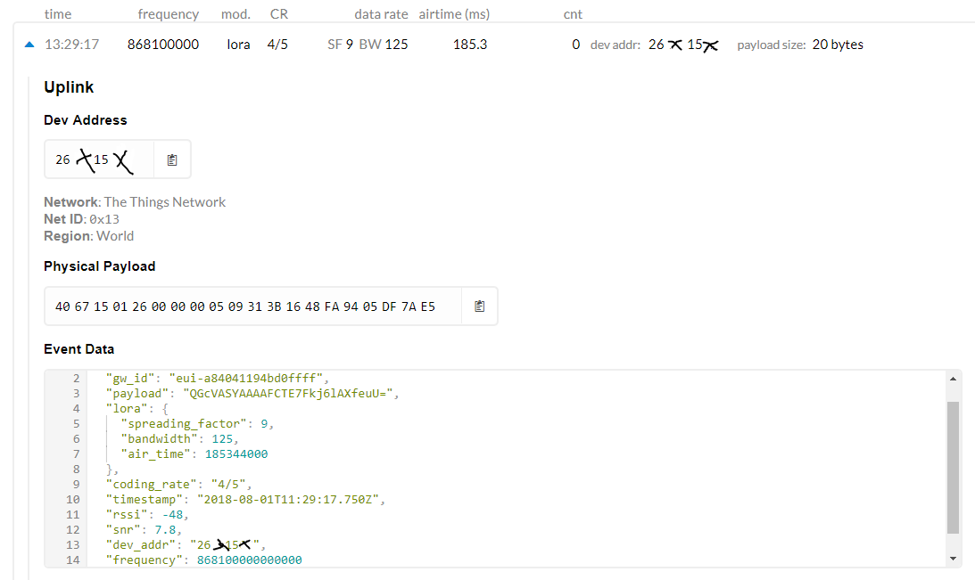

To help you understand what happen here, I can show you the data as seen in the gateway console:
@jota Did you notice that it says retry next the Frame Count and Port Number in your application console and that the Frame Counter value is the same?
The two attempts in your application console are separate attempts by your node to reach the gateway as you can tell by the RSSI values one is -48 and the other -114, not to mention the times are different. The gateway received the second attempt (the one with an RSSI value of -48).
Yes I notice that, and it’s not the problem…
The RSSI difference mean nothing, that’s two different gateway (look at the ID), one one my desk, one at several hundred meters of me, so that’s quite logical to have different RSSI…
The difference in time came from the same reason (in fact that’s how you locate a node with lora. )
Have a closer look to the screenshot, I can asure you it’s the same message.
EDIT: for me the problem came from the info about the frame: if you look closer, the LG01 have a frequency of 868100000 and the others 868,1… Two different way to right it, and I think TTN interpret that as two different frames.
