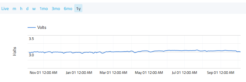

So I have 2 LHT65 . One for over a year and the second one for 3 months.
The battery of the older unit seems to hold its voltage well.
Unfortunately the 2nd , newer unit , shows a quick loss of battery voltage in the 3 months I had it.

Are they running the same firmware version? (Such that e.g. sleep configurations are the same - also can you check internally to see if the builds/pcb’s are same h/w versions? - Not unknown for Dragino to make minor h/w changes for what is then the same Sales SKU) Are you able to measure e.g. sleep currents for the respective units to see if it really is one unit having a problem. Are the batteries the same make and type (chemistry)? Are you able to determine the age of the respective batteries? TBH in my experience these issues are usually a problem of the battery being poor or defective rather than the units themselves. One test is put identical fresh batteries in each unit and restart and see if the same unit dies faster again - looking at your graphs you should get a clear picture within 1-1.5months :wink: If you dont see a repeat building within that time put it down to #2 having had a bad battery and move on :slight_smile:

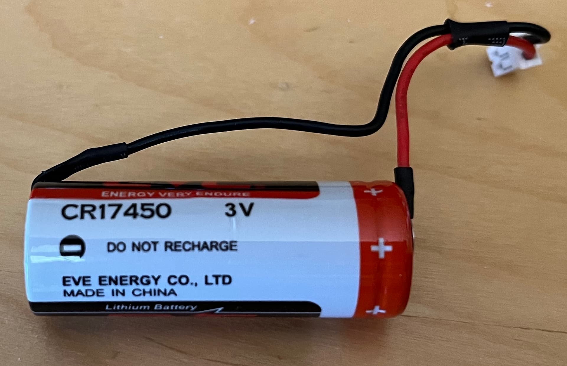

@ bluejedi Since the data of the LHT65 with the dying battery is not important, I wait until it dies completely, then break the sealed case open, examine and replace the battery and report back .
I purchased a FDK Lithium battery CR17450E-R (3V) and soldered the wires to the power clips.
