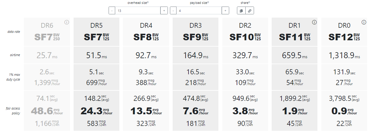

So imagine I roll out 8 nodes with a payload of 4 bytes in your area all TX at SF12 and a uplink every 10 seconds, your gateway have 8 channels.
The calculated air time is 1318.9ms per node, meaning I will take up 13.18% of your gateway time by just uplinks, this is on all 8 channels combined.
Now there are a few MAC downlinks that the NS needs to send to each node, with a downlink the gateway can only talk to one node at a time. While downlink is in progress the gateway can’t receive any node uplinks (it is deaf for this period). The MAC downlinks “manages” the nodes, the RF settings.
By this time we are now sitting anywhere between 13-15% of the gateway available time consumed with 8 nodes. This means you will only be able to roll out 50 nodes maximum on the gateway.
