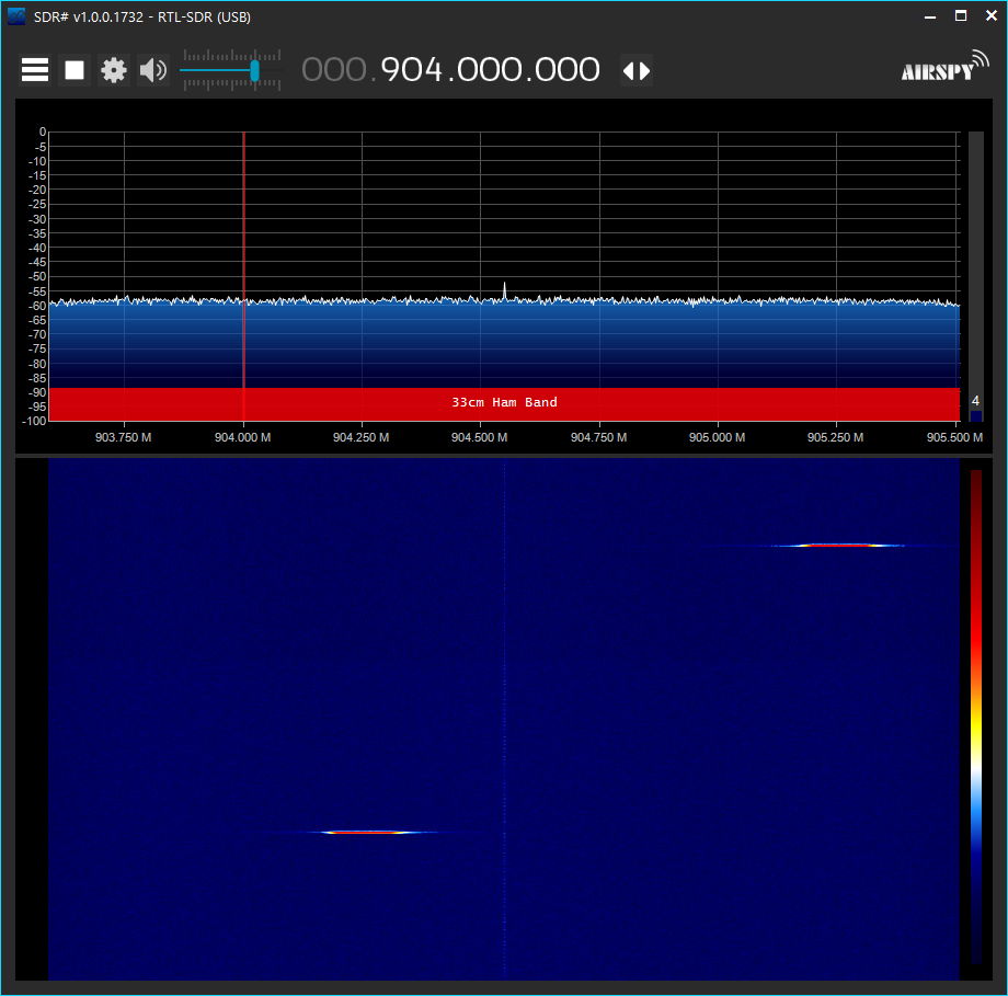

@descartes I think I may found the problem. :slight_smile: It is transmitting on US frequencies!
Here’s a screenshot and they are definitely coming from my device as the timing corresponds exactly to the activity on the serial console plus if I disconnect it they stop.

So it isn’t picking up the eu868 and is defaulting to US. The problem is I can’t see where it is supposed to be defined…

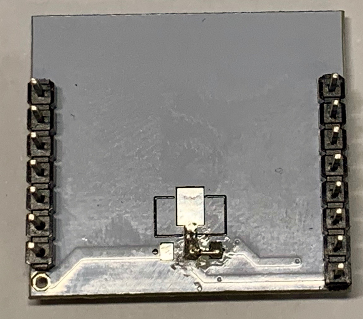

Underneath there is a place where a voltage reg would go for the ESP module - to allow use of the bottom left pin we need to put a small link in. On my picture this is one of ground pins for the RFM, if the RFM is the other way round, it would be DIO2 which isn’t vital but can be useful. Here’s a picture showing how it needs to be bridged:
