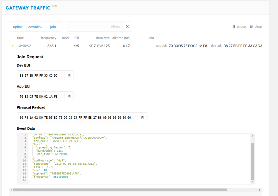

I am getting join request in my gateway, with correct AppEUI and DevEUI as shown in the following image. This request is not forwarded to my respective application.
