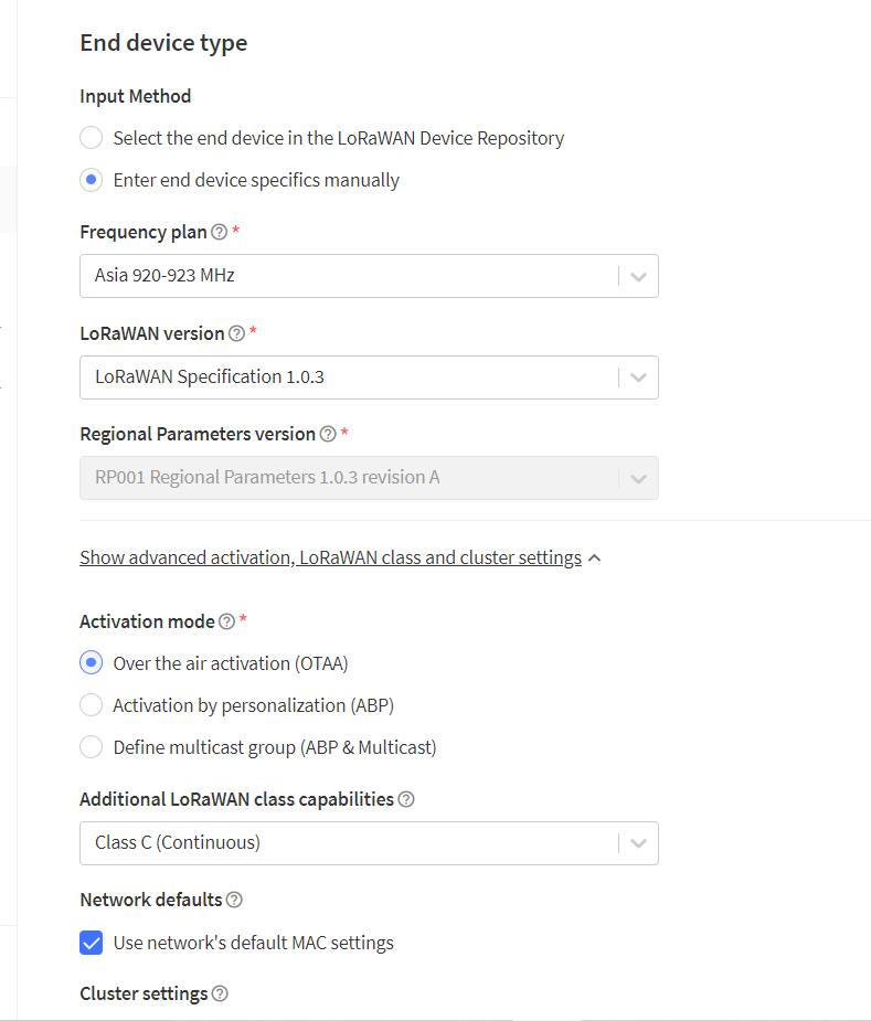

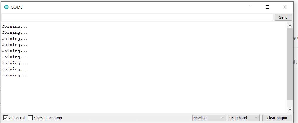

my end node sent data gateway but the data is not showing in livedata, I can’t get the data in TTN. I use beelan library

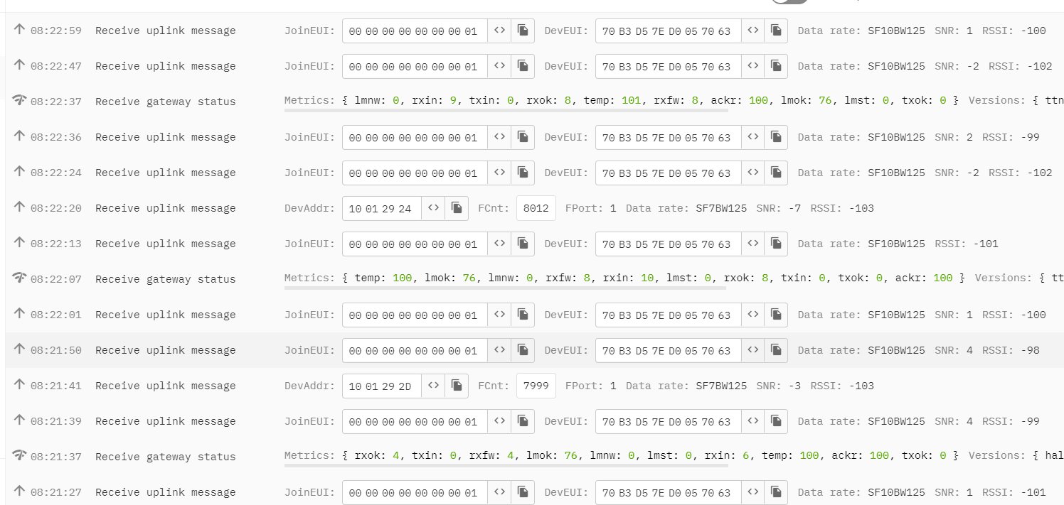

Try class A 1st, double check your detail registration details/keys (can you post settings) - must match the “70B3…7063” we can see coming in over the air… looks like repeat join request cycle…with GW/LNS not sending a response so likely not recognised by the LNS/JS.
I tried class A, but got the same result. I have tried comparing the code and the address of TTN both match.
Like @Jeff-UK said did you check your keys, are they in correct order (LSB or MSB)?
