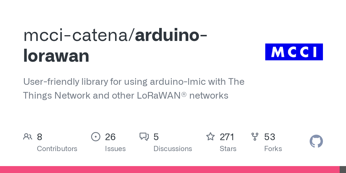

Hi, I agree on the library complexity. At least one the the PDFs around is “simple”, though not easy to apply without examples at hand. However, there you can find answers to the specific questions you are asking.
Regarding a wrapper for LMIC, I think it would be welcome, however there has been already some attempts (I remember to have crossed something on Github, but never switched to them).
Hello, did you have any progress in this way of doing the codes? this would be relatively energetic for the community
Like maybe the following. I’ve never used it:
