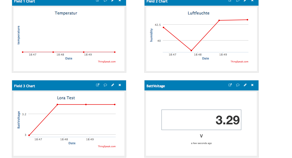

and the result:
  "field1": 21.6,
  "field2": 42.3,
  "field3": 2.93
Bildschirmfoto 2021-01-07 um 18.50.14
