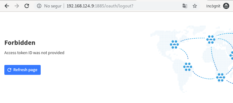

I’m currently testing stack v3.8.4 on a local computer. I managed to connect a gateway and device. But since the beginning I’m facing an issue with the logout process. When I logout shows a forbbiden 403 error.
token-error

Hello Marc,
That’s an odd issue. Can you verify that in the logout URL (the bit you blurred out in your image) there is a access_token_id query parameter present? And if yes, that it is also not empty?

Hello,
I just saw what the problem was. When I initialized the docker I did not define the following attributes:
  --logout-redirect-uri "https://thethings.example.com/console" \
  --logout-redirect-uri "/console" \
Once I ran the command the problem was fixed:
$ docker-compose run --rm stack is-db create-oauth-client \
  --id console \
  --name "Console" \
  --owner admin \
  --secret the secret you generated before \
  --redirect-uri "https://thethings.example.com/console/oauth/callback" \
  --redirect-uri "/console/oauth/callback" \
I think when I set up the docker I followed an outdated guide.
