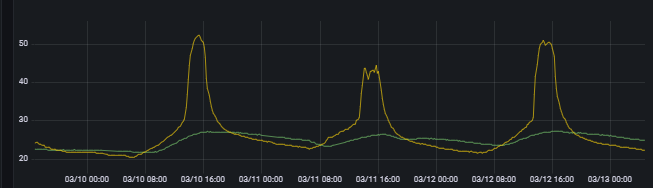

And what temperature do you need to measure that is going to change with in 500mS?
You need to teat something with a blow touch to see that a sharp temperature gradient.
This is a temperature sensor badly placed getting direct sun in the afternoon. Measuring every 10min, reading every 500mS will tell you nothing more.
