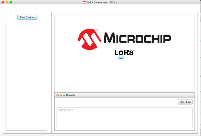

Here is a screenshot of my current LoRa Development Utility:

This opens the LoRa Development Utility, however no devices come up, so when I click “Find Devices” I get this output in my terminal. This happens for every press of that button, however take note that it takes a couple of seconds for the java lines to appear:
Tool List Refereshed
No Server in List
2019-01-12 15:37:10.792 java[11094:275055] unrecognized type is 4294967295
2019-01-12 15:37:10.792 java[11094:275055] *** Assertion failure in -[NSEvent _initWithCGEvent:eventRef:], /BuildRoot/Library/Caches/com.apple.xbs/Sources/AppKit/AppKit-1671.20.108/AppKit.subproj/NSEvent.m:1969
2019-01-12 15:37:10.887 java[11094:278303] -[NSPersistentUIWindowSnapshotter writeWindowSnapshot:length:width:height:bytesPerRow:toFile:inDirectory:encryptingWithKey:uuid:checksum:fd:]: 0 == ftruncate(fd, finalFileSize) failed on line 797: No such file or directory
2019-01-12 15:37:10.888 java[11094:278303] -[NSPersistentUIWindowSnapshotter writeWindowSnapshot:length:width:height:bytesPerRow:toFile:inDirectory:encryptingWithKey:uuid:checksum:fd:]: 0 == ftruncate(fd, fileLength) failed on line 868: No such file or directory
Thanks to some help from sighmon, we determined that the first two java error lines relate to a bug as described in the following links:
From my understanding, these do little more than clog the console. What I don’t understand however are the 3rd and 4th error lines.

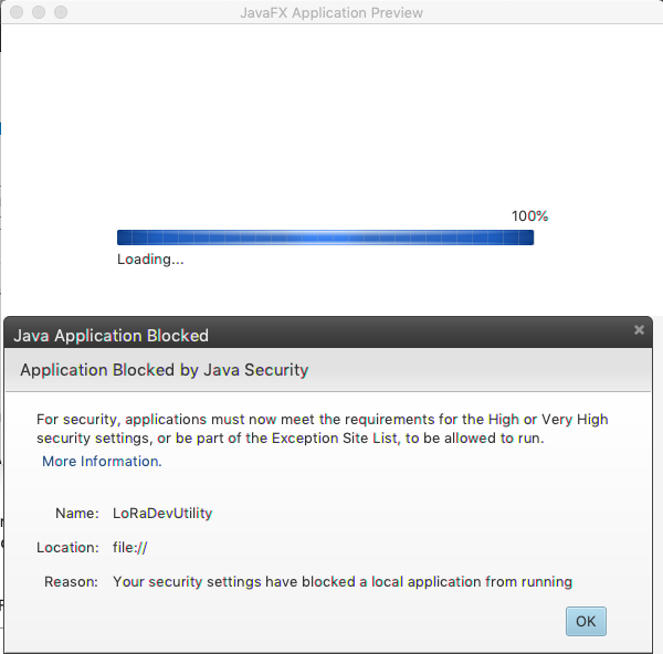

I also have tried opening LoRaDevUtility.jnlp in the LoRaDevUtility directory, however I get this error:
14%20pm
Thinking about it, the errors that I described above were related to Java and if the LoRa Development Utility is unable to access this file due to new security restrictions, these errors may arise. So I went into the Java Control Panel in my security preferences and changed the “Exception Site List” such that https://www.microchip.com/ and/or http://ww1.microchip.com/downloads/en/DeviceDoc/LoRaSuite-osx-1.0.zip is included. I then tried to reopen the file and got the same error.

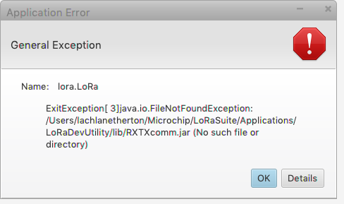

So, I uninstalled the LoRa Development Utility and reinstalled it. I then got this error:
Runtime error. Click for details.
Application Error
General Exception
ExitException[3]com.sun.deploy.net.FailedDownloadException: Unable to load resource: file:/Users/lachlanetherton/Microchip/LoRaSuite/Applications/LoRaDevUtility/lib/RXTXcomm.jar
07%20pm
I then installed RXTX from here and installed it as follows:

But I ended up at the same place with the Java security blocking it, even when I tried:
javaws LoRaDevUtility.jnlp
in my terminal. I’m assuming that I must have had it installed previously.
According to Java on this webpage:
Starting with Java 8 Update 20, the Medium security level has been removed from the Java Control Panel. Only High and Very High levels are available.
The exception site list provides users with the option of allowing the same applets that would have been allowed by selecting the Medium option but on a site-by-site basis therefore minimising the risk of using more permissive settings.
As previous testing shows, after giving an exception to Microchip’s website, LoRaDevUtility.jnlp was still blocked. This means that I didn’t believe the medium security level and the exception site list were the same, so I decided to downgrade.
