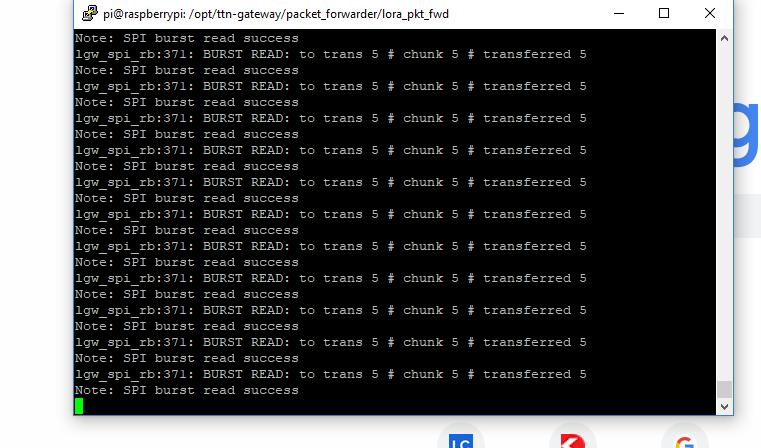

Hi. I am using a RAK833 module. I get this message spam in the console when I start the packet forwarder. Is this normal?Capture

Looks like DEBUG_SPI was enabled in the lora-gateway code.
The read success suggest the connection to the card is working.
Configuration of the gateway library debug output is in library.cfg
I suggest setting the DEBUG_SPI to 0 and recompiling the library and packet forwarder.
