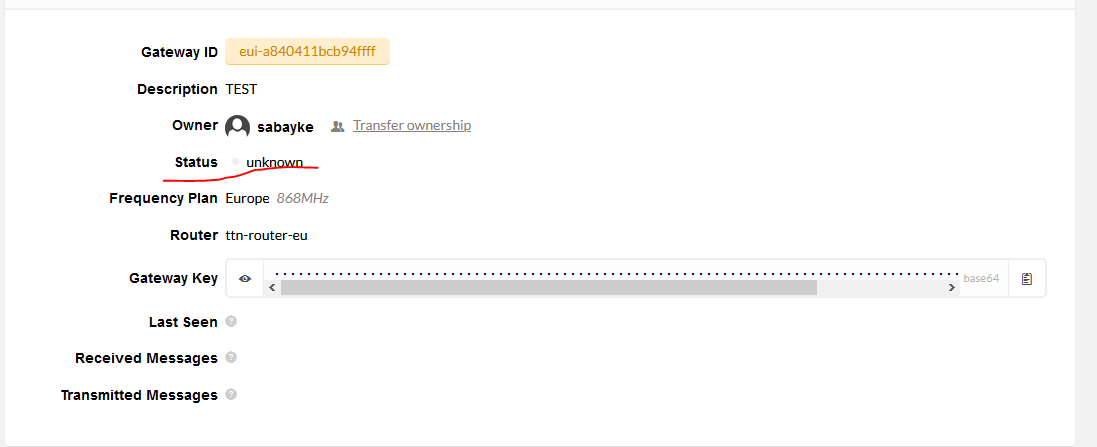

Hi I’m trying to connect my LG01-N DRAGINO to the thing network.
I have seen a lot of video on YouTube but nothing works for me, my biggest concern at the moment is that my gateway does not have an ID and I find it weird

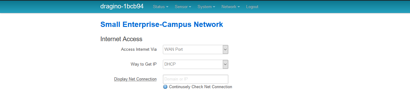

this is my loraWAN
what i tried
