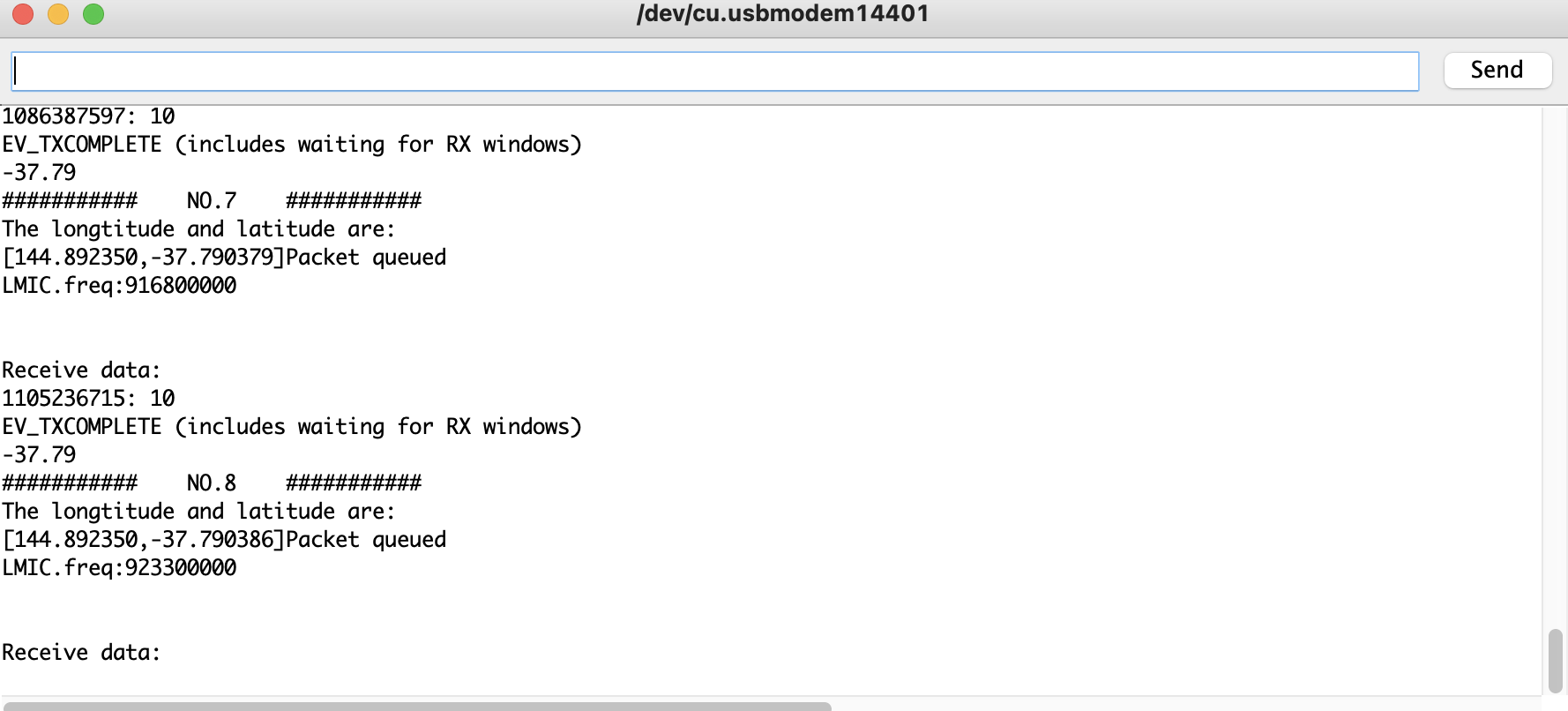

Lora/GPS Shield and ardiuno (end device) to Things network v3
I am trying to connect my Lora/GPS shield and Arduino to TTN v3.
I can see the gateway is connected. but the end device is not showing up on things network.
is it that v3 no longer support Lora/GPS shield ?/

Screen Shot 2021-10-12 at 1.25.07 pm
  • What LoRa/GPS shield?!
  • It’s the other way around.
    V2 never supported your shield. The node (with your LoRa shield) supported/needs to support the LoRaWAN network (which is taken care of by the LoRaWAN stack, in this case the LMIC library). There have been introduced some changes (e.g. stricter LoRaWAN requirements) in V3 when compared to V2.
Dumping your sketch / source code makes no sense if you don’t provide any useful information and details about your situation.
Don’t make others have to guess and ask you for essential information.
There is much existing information related to V2 to V3 migration available on the forum that can help you.
If you have problems getting something to work then first try the standard LoRaWAN basic examples included with the LMIC library (or LMIC-node if it supports your board).
This will make it easier to troubleshoot LoRaWAN issues.
Also be aware to use a recent version of MCCI LMIC. Latest (currently v4.1) is preferred, use v3.x at minimum. Older versions do not (properly) support MAC commands.
