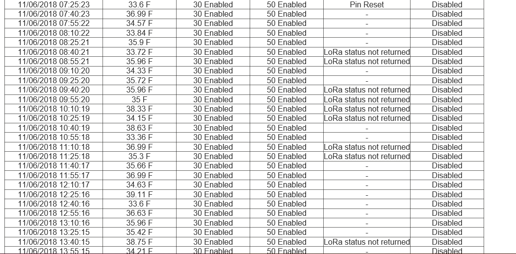

(Jlcolemanttn) #4
Kersing,
Below is a screen shot of the results of our LinkCheck Request testing. Sometimes we receive the ack back from the network and sometimes we do not receive the ack back. After a period of time, our end node stops receiving any acks back from the network. We are still connected to TTN because we are able to uplink our data from flash memory to our AWS database, but LinkCheck Request fails.
