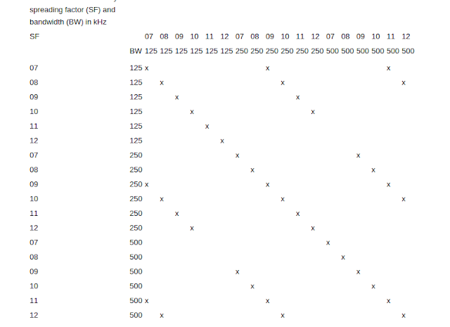

‘x’ represents the non orthogonal combinations
source

Thanks for the chart but I’ve seen it. My question stands - what do network architects do about this? Does LoRaWAN somehow take care of the non-orthogonality? Is the ADR mechanism smart enough to not ask for changes to SF that would break orthogonality?

Looking at the chart supplied above, it appears that there’s an issue with two devices transmitting simultaneously, using a combination of SF/BW that creates the same chirp rate. Is that true (it seems the point of the chart), and if true, is that not a problem for the receiver?
