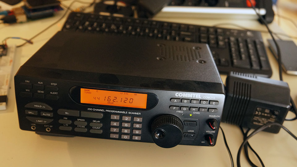

after some digging found this old scanner… will that be enough. probably not :sunglasses:

That receiver will probably do maximal 25 kHz band width which is too small for a 125 kHz LoRa signal.
