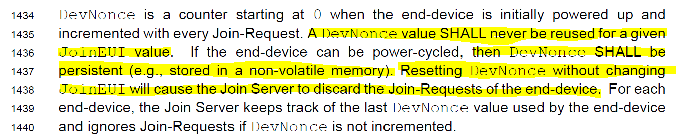

Thank you, but I’ve read it before, several times, hence my original commentary - and for readability I’ve adjusted the image - please do not post images when you can copy & paste text.

Thank you for adapting the image size. I used an image because it was easier to highlight the text.
The specification mandates the use of some sort of persistent memory.
ā€œIf the end-device can be power-cycled, then DevNonce SHALL be persistent (e.g., stored in a non-volatile memory)ā€
The important word here is SHALL.
