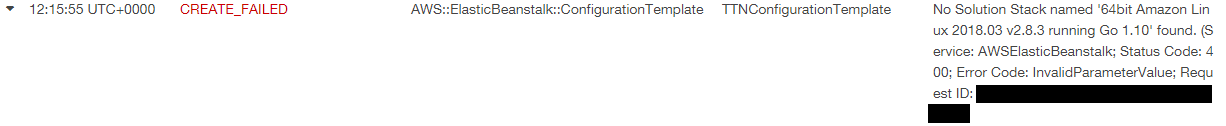

(Sj Kear) #2
Have received the same error (No Solution Stack named ‘64bit Amazon Linux 2018.03 v2.8.3 running Go 1.10’ found. (Service: AWSElasticBeanstalk; Status Code: 400; Error Code: InvalidParameterValue; Request ID: )’ when trying to generate the stack via the AWS Quick Start instructions on the TTN website ((https://www.thethingsnetwork.org/docs/applications/aws/quick-start.html)
error
Could the TTN ‘cloudformation.template’ be updated (https://s3.amazonaws.com/thethingsnetwork/builds/integration-aws/dist/cloudformation.template) or as @hs1 requested someone advise on how to resolve this.

#4
Yes this is pretty inconvenient in AWS CloudFormation. If anyone knows a way to indicate “latest Go environment” (instead of checking this page regularly), please let me know. In any case, we’re stepping away from Beanstalk for V3 integrations.
A new build with CD is on its way; the hosted cloud formation template that @SJKear mentions will get updated within minutes.
edit: done
(Sj Kear) #5
Agree - bizarre AWS has implemented it in this way…
…but pleased to say this has resolved the issue (now have data flowing from node into AWS) - thanks @johan for the extremely swift support and updating the cloud formation template!
