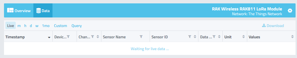

I’ve setup own account in myDevice service, create new device record and put DevEUI in corresponded field. In the TTN Console start ‘New integration’ wizard and put GUID from the myDevice URL, according instructions.
After that nothing happens… “Waiting for live data”MyDevice-1
Whats wrong?

Is your device sending the payload in Cayenne LPP format? No decoder is required if so.
Yes, node is using Cayenne LPP format for payload data, but I’m using custom decoder for calculate additional field.
