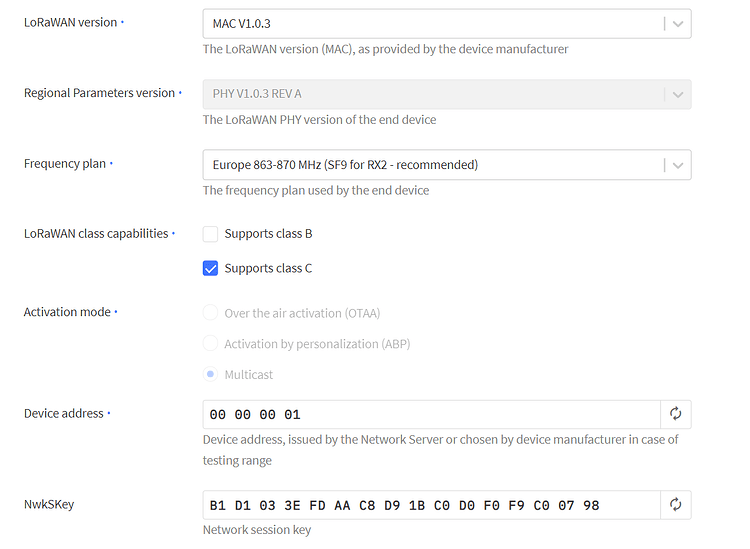

I thougth I’d change DR from 0 to 3 (SF 9) on RX2 window but a multicast profile in TTI is a virtual profile that is not associated with the physical end-nodes.
If I’ve understood correctly the setup of RX2 window is done on the join request-accept so a virtual profile can’t do this . Is that true ?

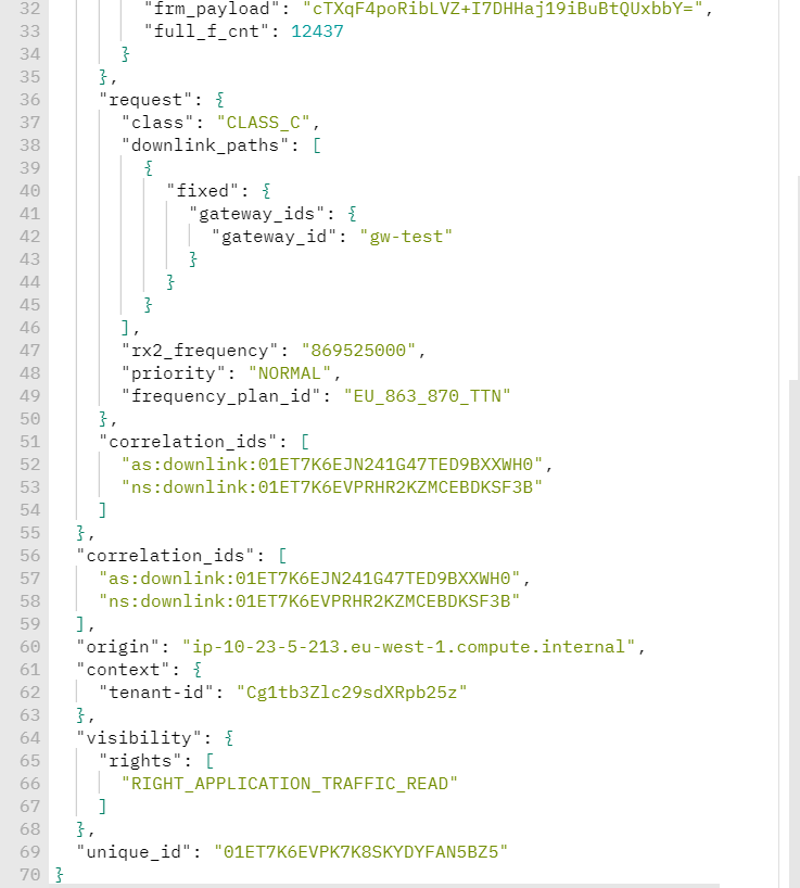

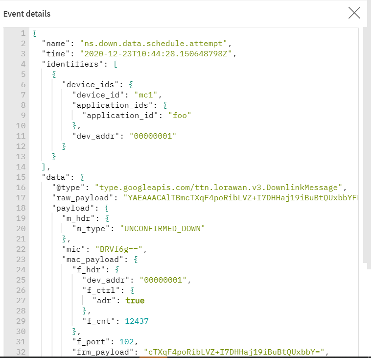

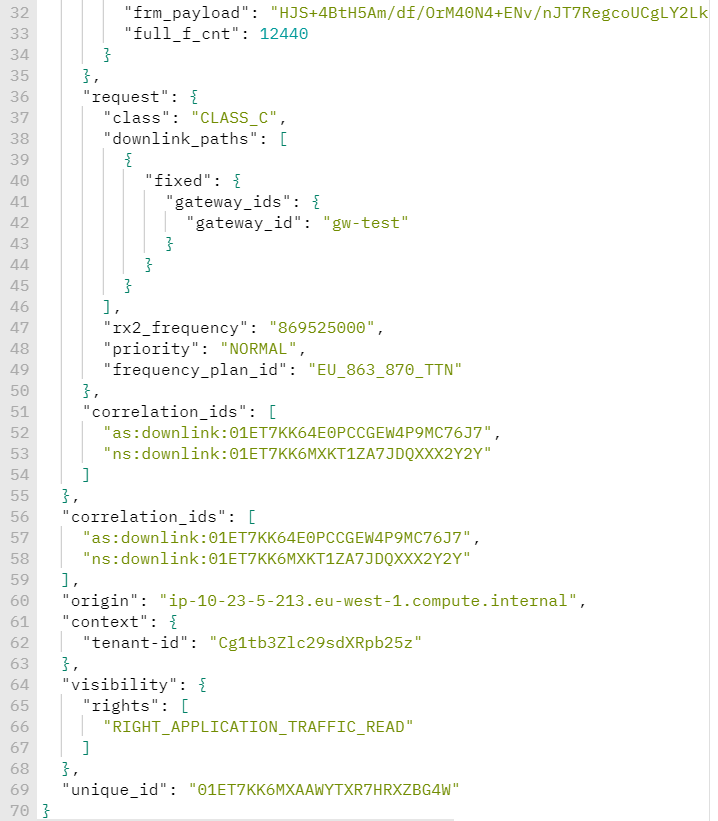

When i Schedule less than 29 bytes TTI send on my end-nodes that data:
Cattura1
Cattura2
MIC (TTI) : “BRVf6g==” (base64) —> 0xEA5F1505 (hex)
My end-nodes when receive that packet save MIC(TTI) inside “expectedCmac” variable than calculate the MIC from the MAC payload and save the result inside “compCmac”. Finally check if “expectedCmac” is equal to “compCmac”, if it’s not there is a problem on message integrity.

When I send less than 29 bytes or less expectedCmac = compCmac = 0xEA5F1505 that corrisponds with MIC encoded by TTN.

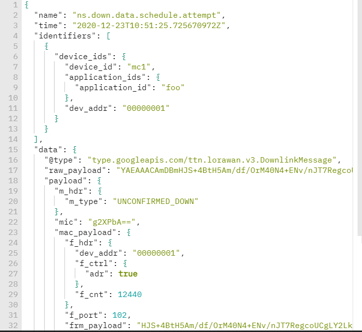

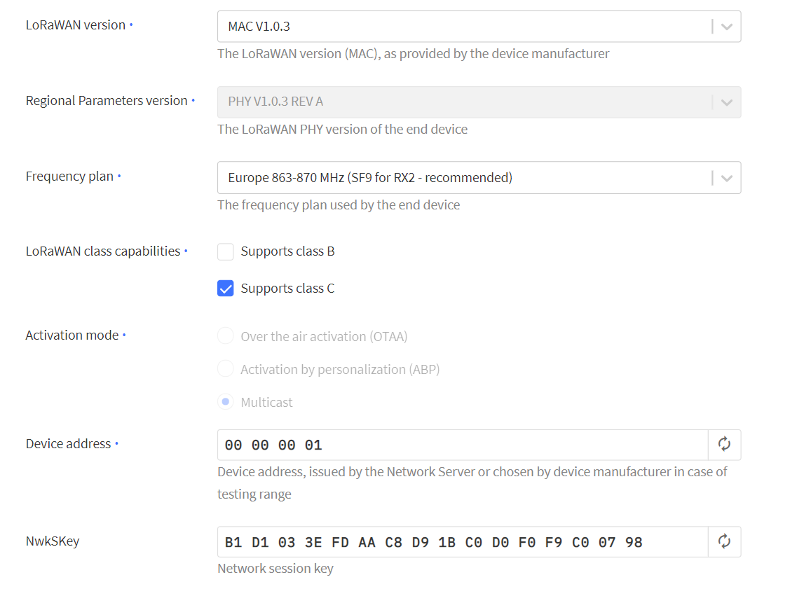

When I schedule 51 bytes these are the results:
Cattura3
Cattura4
MIC (TTI) : “g2XPbA==”(base64) —> 0x6CCF6583 (hex)
expectedCmac = 0x280D2AC compCmac = 0x14BA7C0D
Why is it so ?
I would like to know only how to set RX 2 of multicast profile on DR 3 (SF 9 / BW = 125KHz) because even if I set this on multicast profile (as you can see on the picture down) my gateway continue to schedule downlink on SF 12

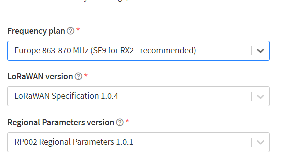

Any updates? I have the same issue, i am working on FUOTA campaing, and multicast class c devices are in DR0 (SF12) RX2… more than one hour to update them.
In TTI Front end is not option to change RX2 (
It is still in SF12 in lieu SF9 as it is showed in above image.
