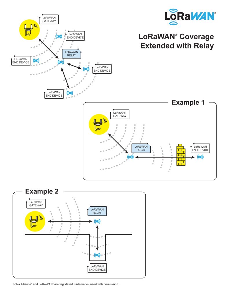

Hi all,
How to implement this relay feature?

Whilst a permanently listening LoRa device acting a relay can in effect double range, the relay feature described uses CAD to detect on air activity and when I tested this there was a drop off in effective sensitivity, i.e CAD did not detect the weakest signals that could have been received.
And if you need to put in a lot of these ‘relays’ to reach distant nodes, then maybe a better placed Gateway is what is needed.
