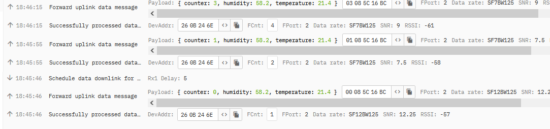

The issue still happens. There is no other board connected. Below is a snapshot from TTN. My software sends constant humidity and temperature values, and also a counter (1 byte) that gets increased. This way I can see all the packets that are sent. Below you can see No.2 packet is missing.

I will have to look into the gateway to see how I can do this. I see the first transmit is SF12, and then goes to SF7 , but cant see what the missing packets are sent unless I see the gateway traffice, which I will take a look at.
