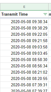

I am using a setup where application data is sent from TTN via a HTTP integration to google sheets. I can’t remember what tutorial I used to set this up, but it was something along these lines.

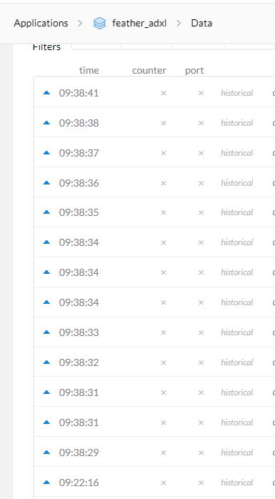

Usually this setup works fine, but I have begun to notice that some messages are not transmitted properly (are lost). Would anyone know why? Could it be that the google sheets is script is being overwhelmed or something? And where should I look for the problem?
are you really transmitting data every second?
that would be not fit inside the fair use policy
