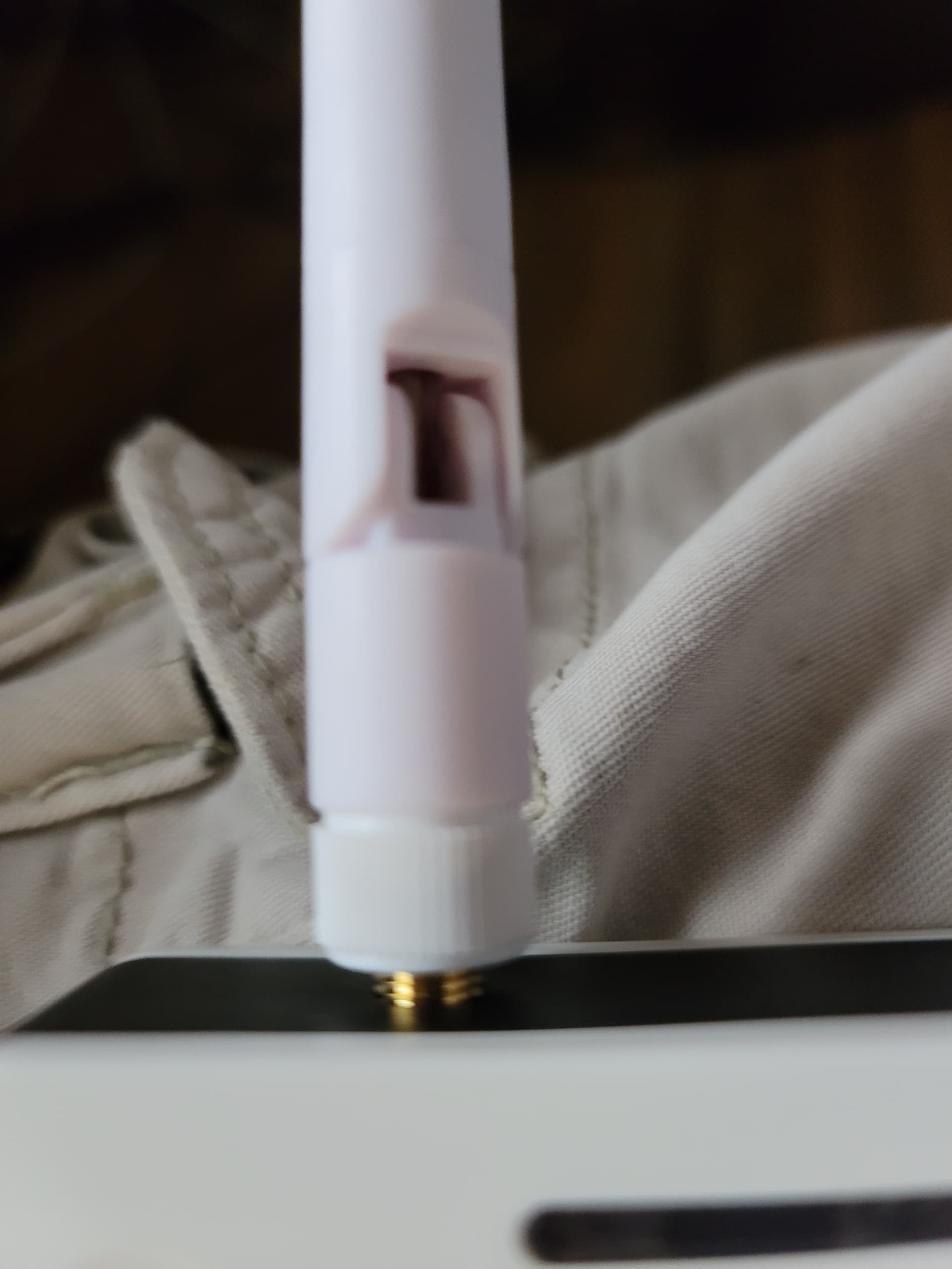

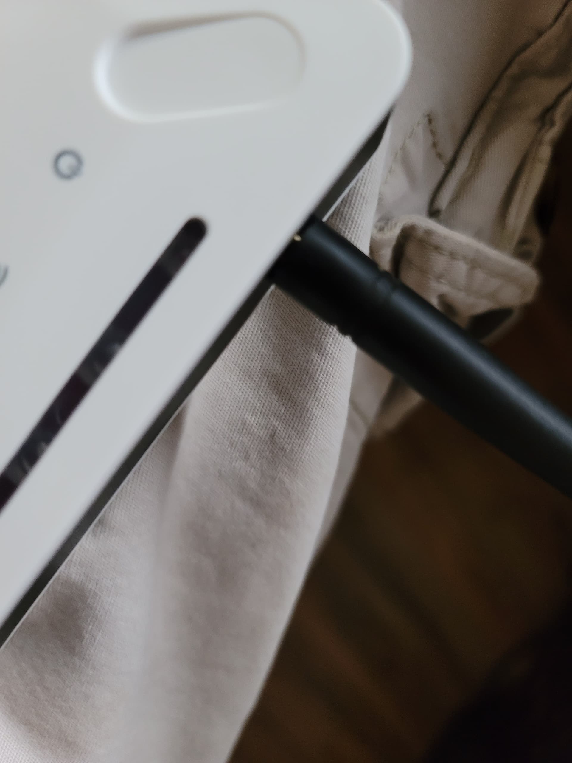

Can I try one of the antennas from the lds03a on the lps8 gateway or will it damage anything. I tried twisting it on (with no power) and noted it seats much further than the stock antenna that came with the lps8
The black antenna is off the lda03a
The white one is the stock that came with the lps8 - note the gap.
In theory yes…. It will depend if sma male, sma female or rp-sma m or RPi-sma f……. A picture paints a 1000 words! Gap irrelevant as will depend on the specific mechanical design of any given ant……
I gave it a shot - put the lds03a ant on the lps8 - no change…in fact, somewhat worse - I had to stand like 2 ft from it to get it to send anything to the gateway.

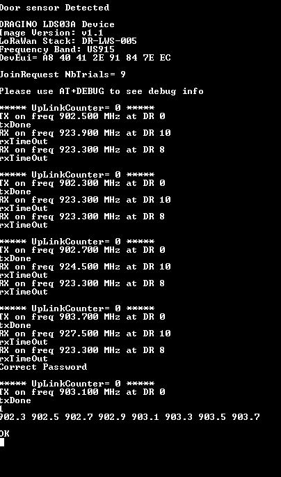

You need to switch to CHE=2. Your node is currently using 64 channels where the gateway listens at only 8.
This should be CHE=1 for 8 channel mode.
I noticed all uplinks you show are at the same frequency (905.3), the last one of the channels used by TTN. It is almost like your nodes are using the next set of frequencies. Check if your nodes use the frequencies listed at https://www.thethingsnetwork.org/docs/lorawan/frequency-plans/
@kersing - I was super excited - I thought you were on to something here - but same after setting lds03a to AT+CHE1
From the serial of lds03a -
@kersing - also with AT+CHE=2
Look at the TX frequencies and compare to the page I linked to. The node is using the wrong frequencies.

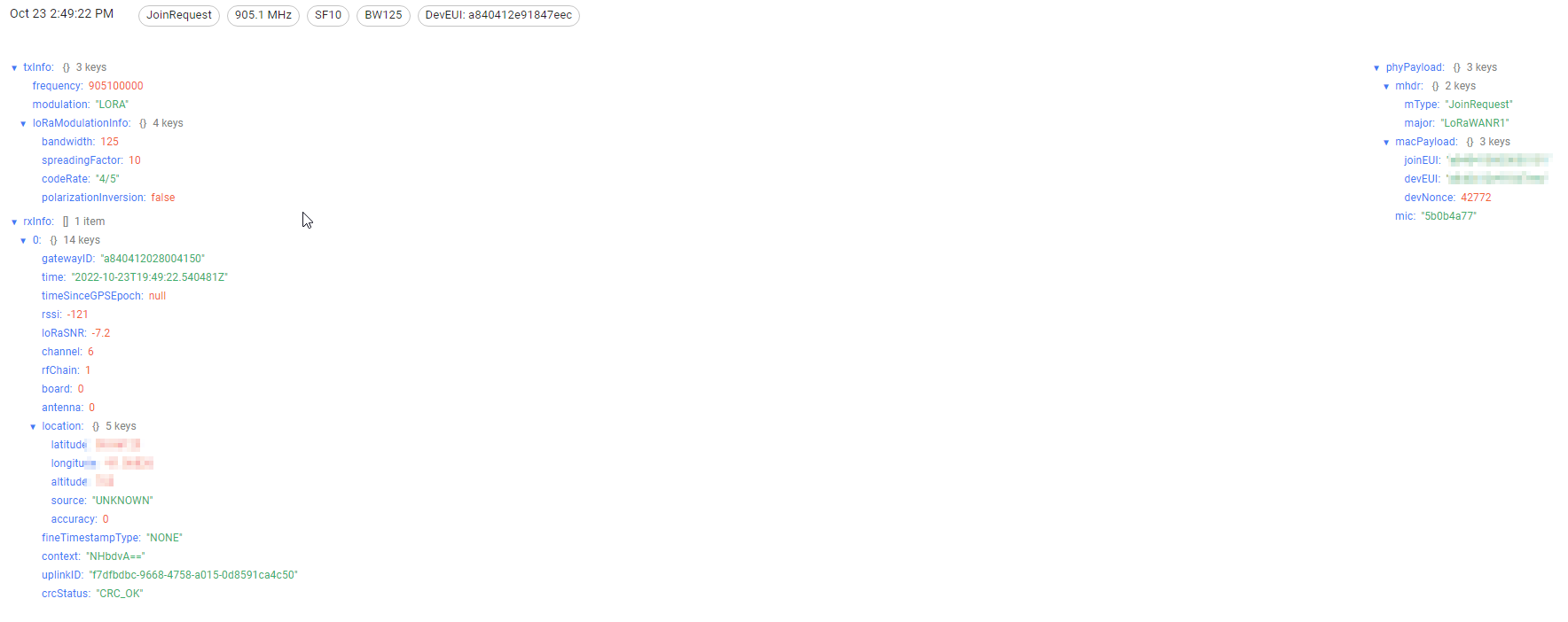

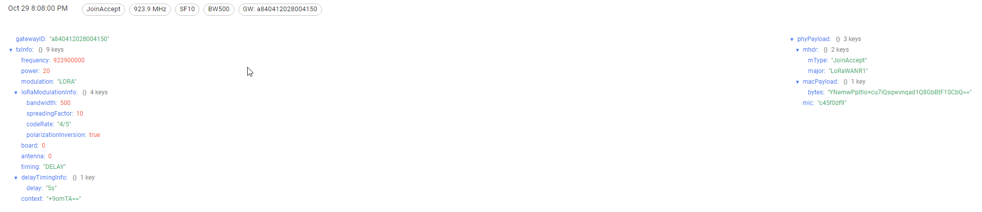

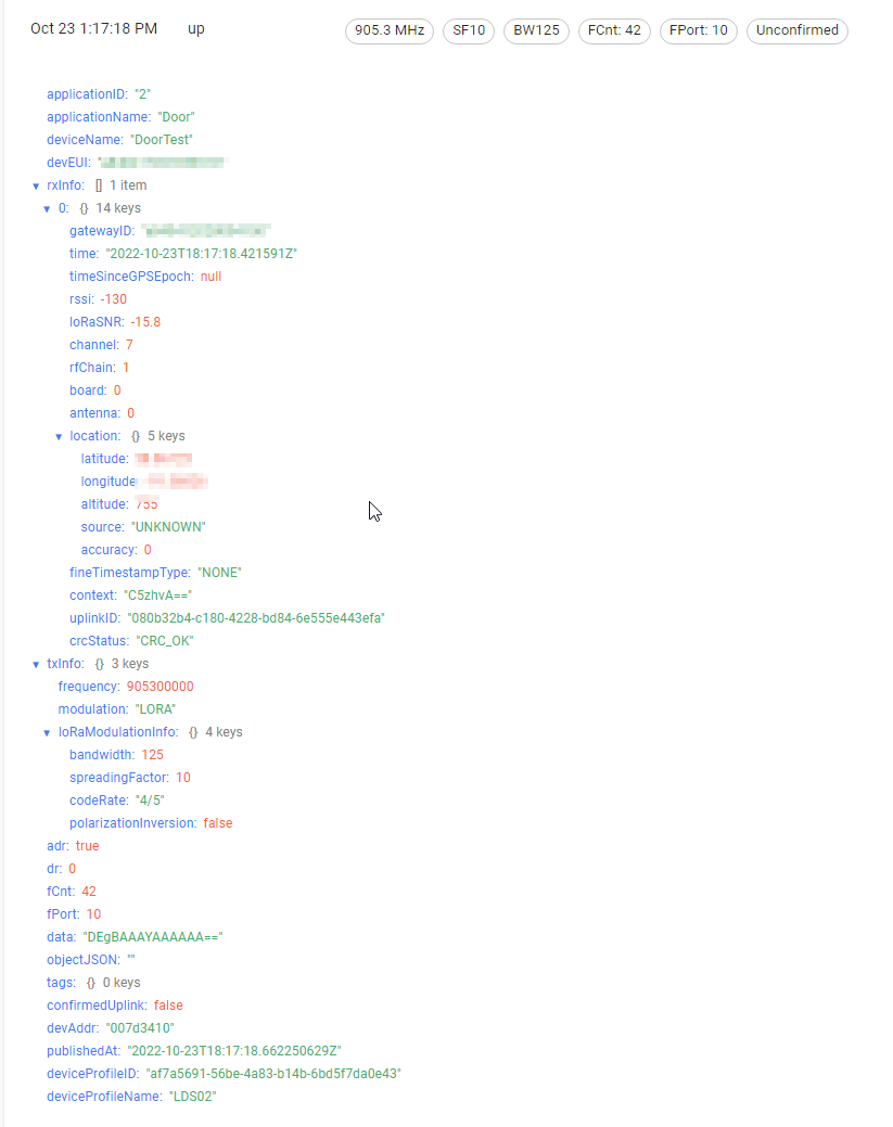

Stumbled into something tonight - see attached pics. I am using Chirpstack - I’ve been out on vacation and obviously have not done anything since being gone. I logged into the chirpstack server (RPI 3) I’m working on all this with - noted it needed some Ubuntu updates - ran apt update/upgrade and noted it updated chirpstack and restarted it as a result of new updates.

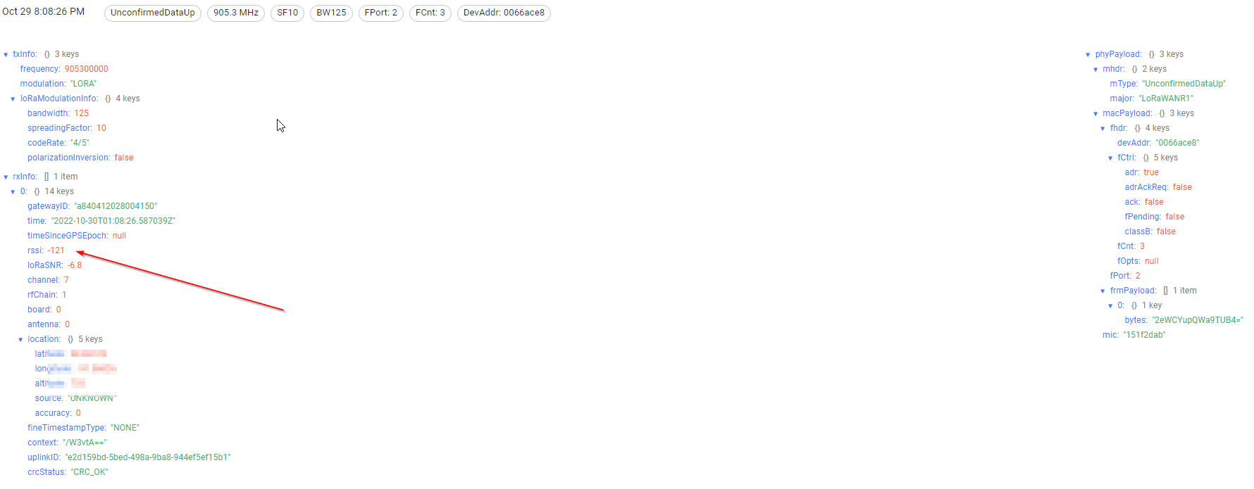

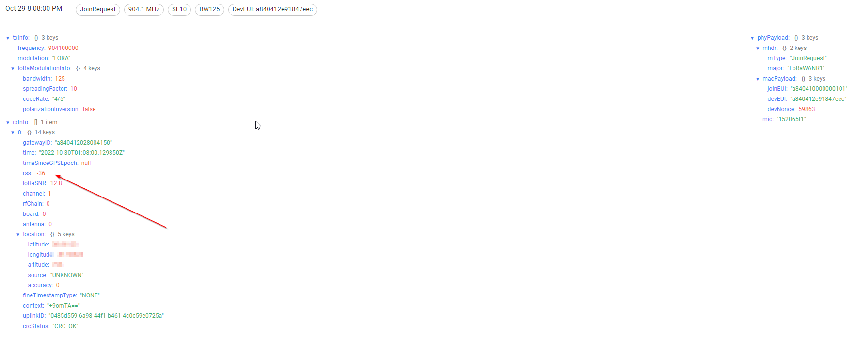

So after it was done - I tried the lds03a again -turned it on - saw the join at -36 rssi and I was like wow! So let’s see what happens if I send an open/close with the end node now. It dropped right down to -121. So it ‘feels’ like the ADR might be sending something funny from Chirpstack to change the power/channels etc. Screenshots to follow.
Join Request:
Join Accept:
Node Sending Open/Close Data:
