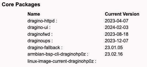

Got an answer from the Dragino Tech support. No manual update (at least they do not indicate where to find the .bin for the LPS8V2). Update is done via OTA and the latest FW version is as per the picture below.
