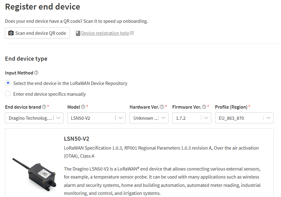

I have been using an LSN50v2 in MOD3 (the ADC mode) along with TheThingsStack community edition and Firmware version 1.7.2 for several weeks.
The setup was working fine without any changes. Today, I have noticed that the payload isn’t decoded properly anymore, giving following error:
"message": "TypeError: Value is not object coercible at main (<eval>:208:30(29))"
For this payload (no payload is decoded properly):
071E02D20E4308FFFFFFFF24
I am using the device repository decoder:
