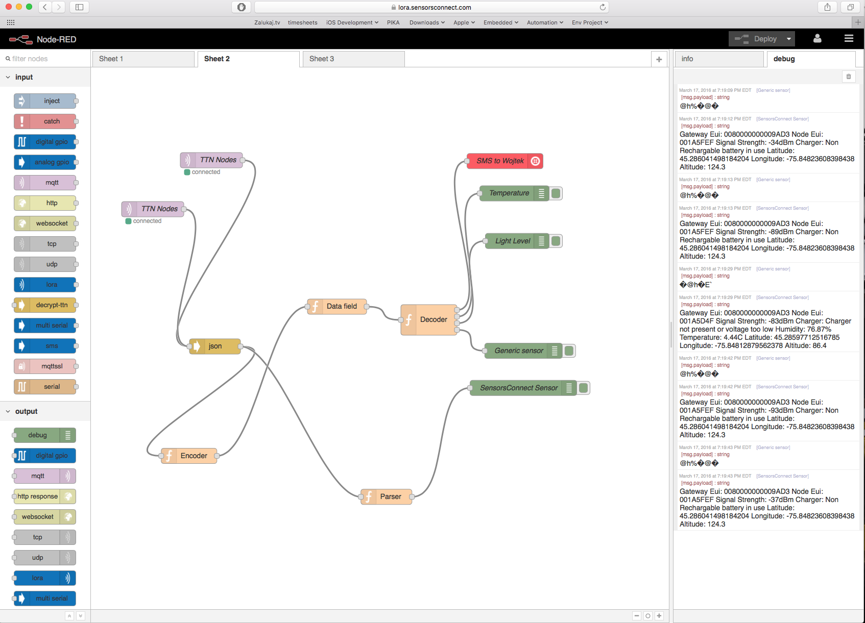

We use node-red version where we run a LoRaWN for a small site like a building.
write from the gateway to a MySQL o MongoDB database?
Yes … sort of if you have had a REST interface to those DBs.
What we and many others do is use a cloud IoT service to store all sensor data.
We like opensensors.io It’s free for all public data.
