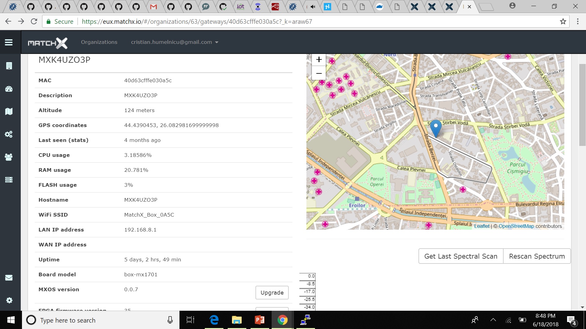

If OTAA problems is still on, try to test the MatchX Gw with MatchX Cloud backend just to be sure is not a hw problem.
I have a MatchX Gw in TTN Network and working without any problems with 0.07 fw , but working before with 0.05 fw too .

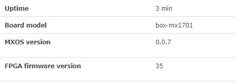

Firmware version 0.0.6+0.0.7 cause crash of LoRa HAL, due to unmatching version of FPGA (v1)
With 0.0.5 the gateway boots without error, but i don’t see any rxpkt/txpkt log entries, just the stats packet going up to TTN.

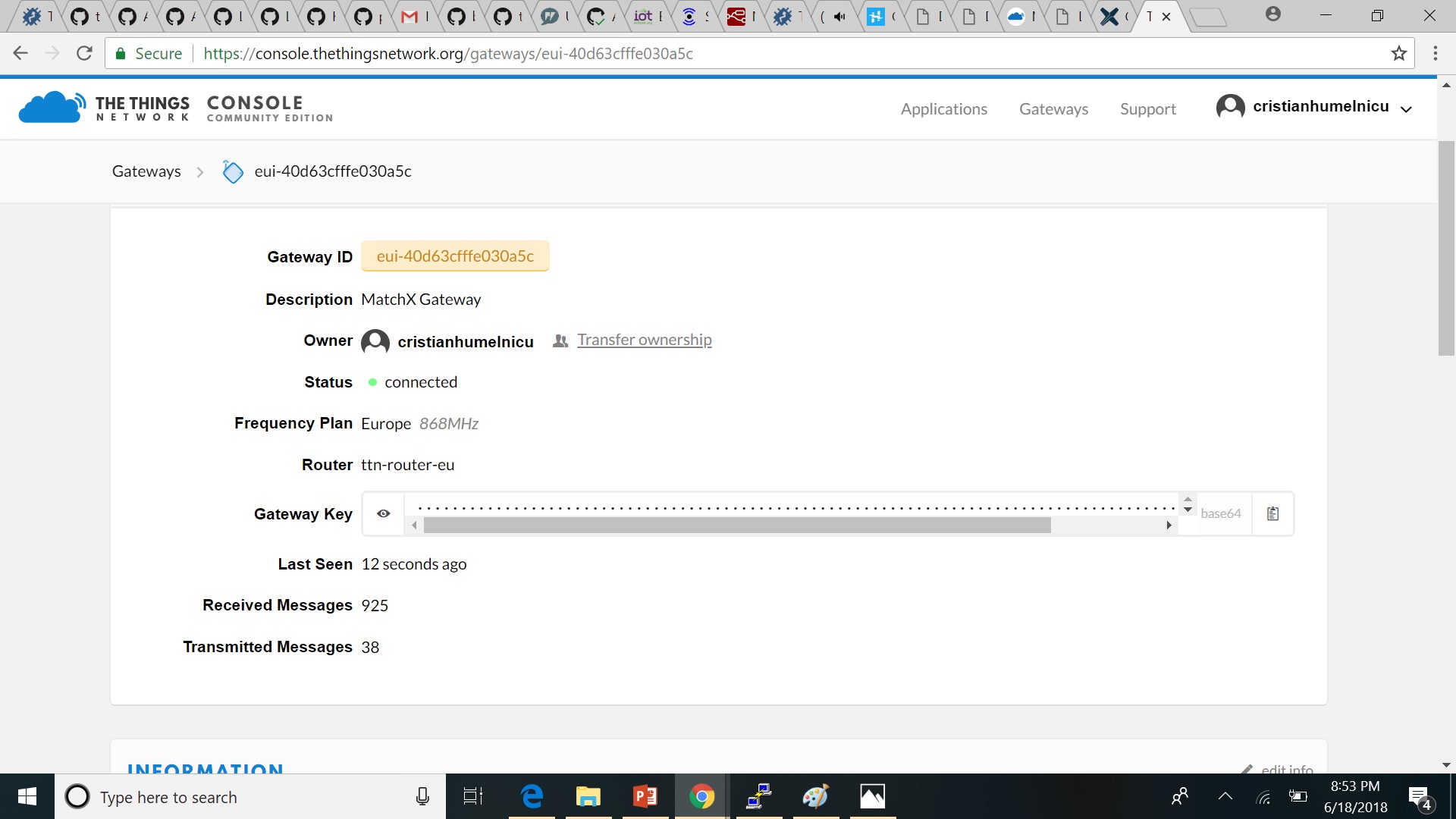

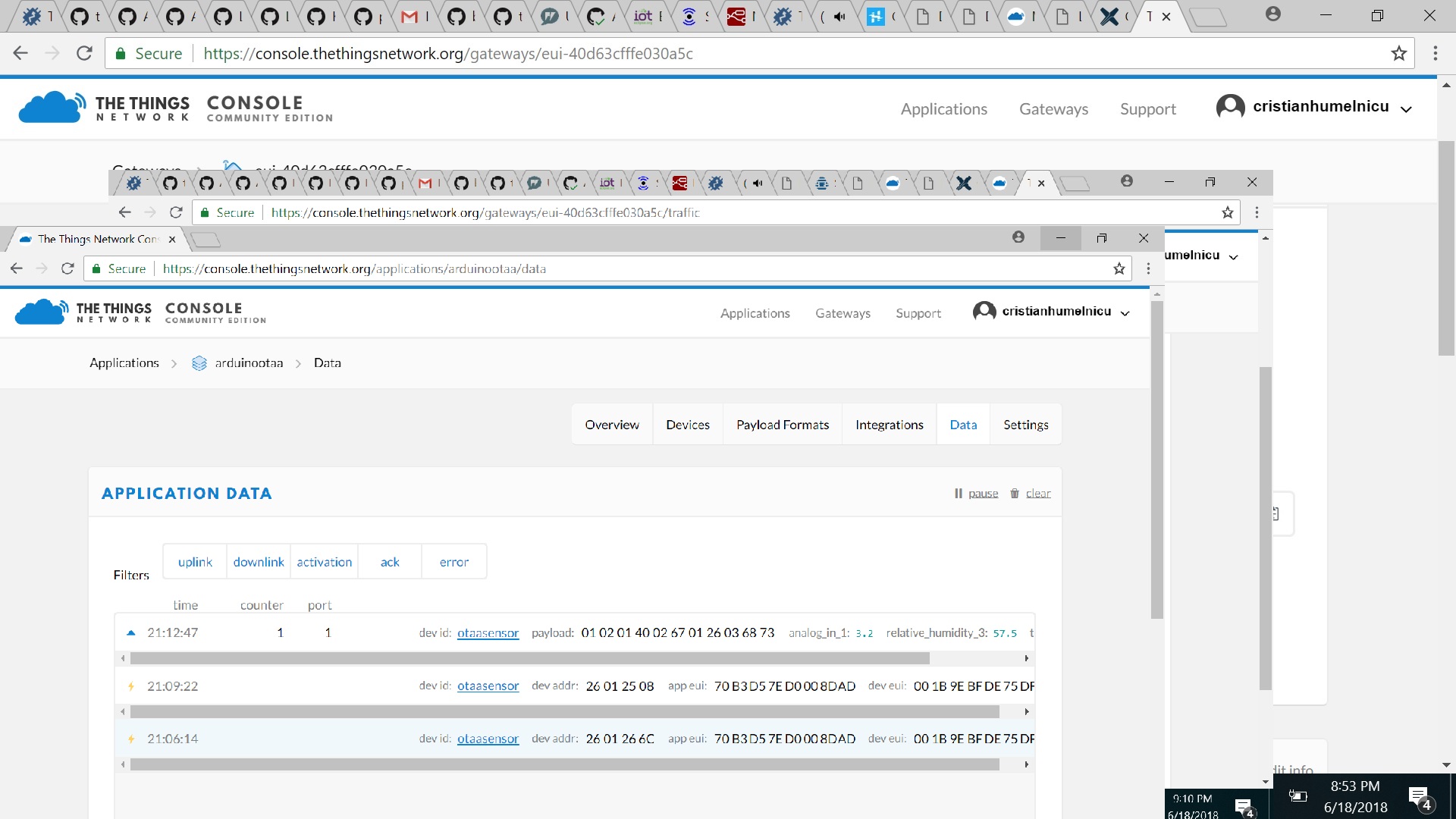

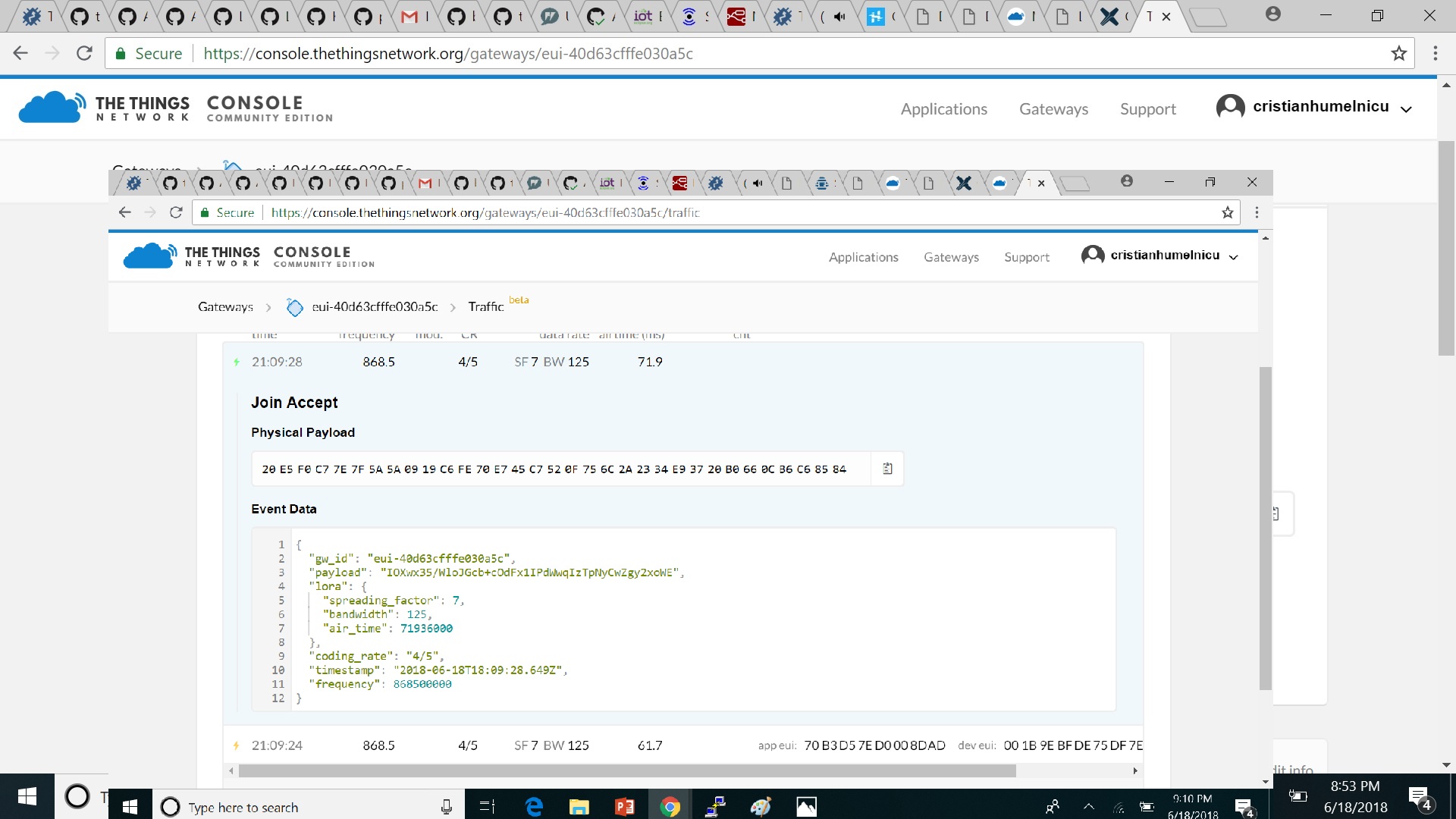

I dont know … here all seems ok !
alles prima mit matchx 007
And here is node join … so i think is nothing wrong with ttn or with MatchX fw
