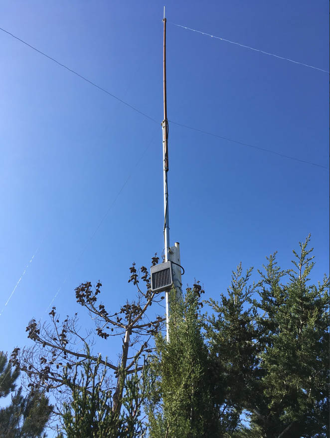

I look at this photo
what maximum cable length do you have on your gateways?
