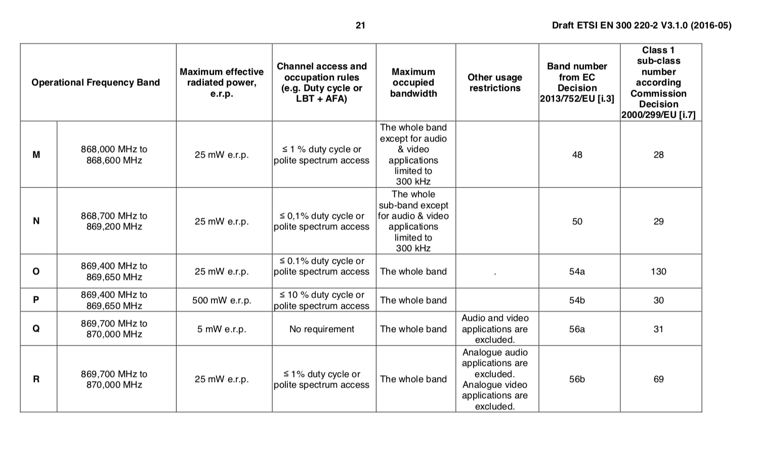

As I read the EU spec there’s a small sliver of frequency (869.4 - 869.65 MHz) that is allowed to go up to 500 mW (27 dBm). What are the drawbacks of using that band, is it too thin for channel hopping, etc?
Specifically line P in the following excerpt:
13%20PM
I believe the key point of that band isnt just the TX pwr option but the fact that it allows for 10% duty cycle and is therefore useful for the GW’s (which clearly have to serve a greater number of nodes) to use for ACK’s and DL/Confirm/Join Ack msgs - RX2 window (RX1 follows the Node TX characteristics). Note also that if nodes close to GW and lowering TX power an option then ‘Q’ has interesting possibilities wrt duty cycle/message on air time (SF) and payload length…just whisper it vs shouting over people :slight_smile:
